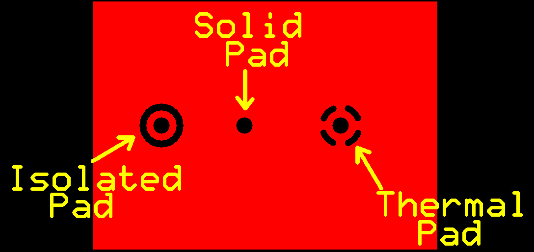

2) When I make homemade PCB I avoid joining components directly to the top layer (I use a via) because its hard to solder the top layer. Am I correct in thinking this (and vias) won't be a problem. The printing process will deal with them.
The poured copper will sink much of the heat from the source. Avoid using vias and instead use thermal pads in the plane, which will sink much less heat when solding.
Sorry!...but can you please explain what you mean?
After re-reading what you wrote initially, I realized you may not be talking about either a power or ground plane with poured copper about the component tie points...my apologies if I made an assumptive error and confused you. I have attached a graphic that displays an isolated pad, a solid pad in a pour and a thermal pad to display the differences, which should display my original interpretation and to show the differences…maybe for your future reference.
But then that begs the question why you have a problem soldering from one side or the other if no heat sink exists. Perhaps you could explain the issues/circumstances you are having in those cases.
