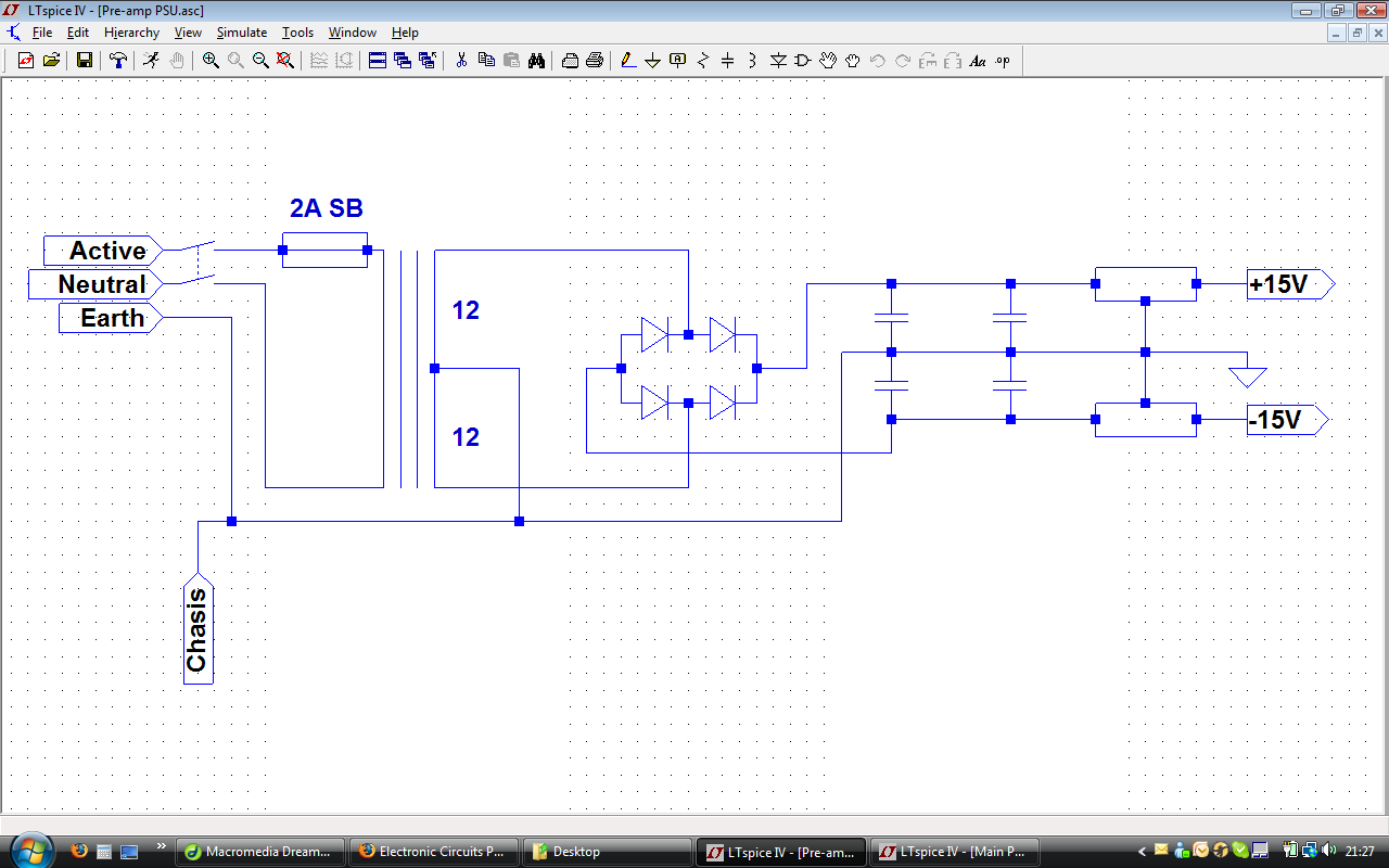

I have a 12-0-12V 250mA transformer in operation from the mains supply.
The circuit diagram is attached and I've double checked - it's wired up exactly the same. The capacitors are 50v 2200uF.
3 of the four capacitors heat up within a few seconds and the tops are beginning to bulge slightly. The only one that appears to be ok is the first one between 0 and +15. The output between 0 and +15 is about 16.4V - correct (the boxes represent fixed 15V regulators which haven't been installed yet). The output between 0 and -15 is only about 6.3V.
It may be worth noting that for a few seconds the second capacitor between 0 and +15 was connected in reverse (the positive side on the 0V rail).
Can anyone identify where I might be having a problem?
Thanks,
Mark

Sounds like the capacitors are either wired up with the incorrect polarity or are faulty. Certainly connecting them in reverse, even momentarily, can cause them to fail.

I have replaced all 4 capacitors but now only have one each side. The one between 0 and +15 is working fine and the output is about 16-17V. The one between 0 and -15 is still heating up and the output is about 8-9V. I don't understand where the problem could be.

Do you have the capacitors on the negative rail connected correctly?
That is, with the + side going to your 'chassis ground' rail, and the - side going to the -15 volt rail?
Why did you connect PE (earth) to circuit ground? Earth is only used for mains loads.
Posting a schematic which has problems with the polarized caps, and not including cap polarities on the schematic is, well, errmmm,...
1) Check the capacitor polarities and add them to your diagram.
2) Check the capacitor voltage ratings and add them to your diagram.
See you back here soon!!!
I would have you also double check for proper diode polarity wiring. The drawing is correct but it sounds like you might have some of the diodes wired wrong and sending AC to the caps which will destroy them. That or caps wired in backwards but thats already been mentioned.
