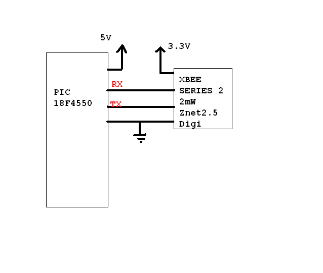

So changed End A to another mircontroller setup (basic connections as in picture) and connected 2 LED bars on End A to see what was sent and what i received.
On End B i added a LCD to see what it received.
I first connect both serial connections with wire to check if both programs were working .. and they are .. no problem when both end connected with wires directly to each other.
but when i connect Xbee on both controllers (on their serial port as in picture), nothing happened. no transmission at all.

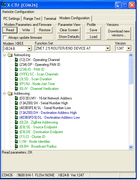

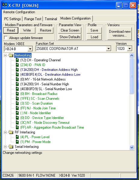

Can some one tell me what am i doing wrong. I have also attach the config pics of boht Xbee modules.
