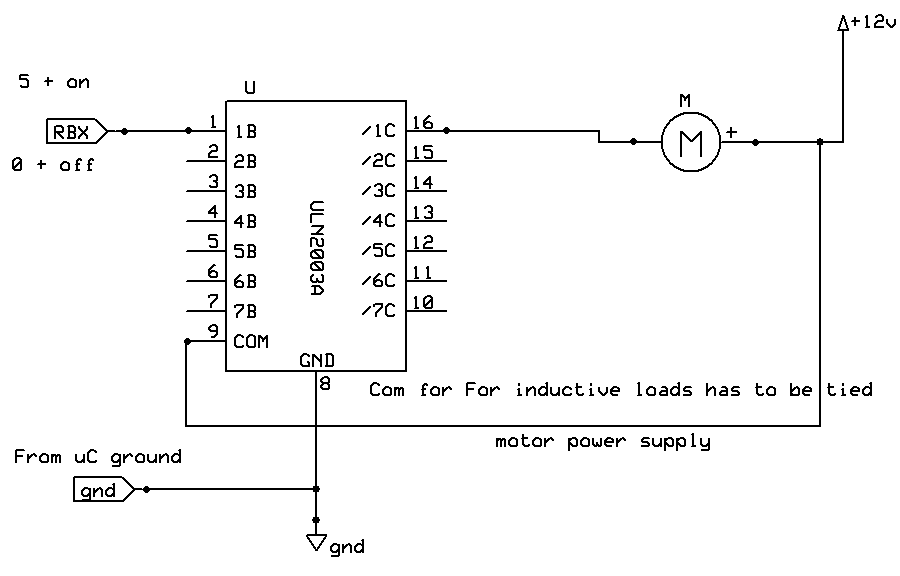

hi :) I tray to drive stepper motore using PIC and my problem now that the uln2003 ic not work propably . I connect its PIN8 to GND and PIN12 TO +12 V but when I put the 5V in the input pin i get only 0.6 v in the out put pin !!!!??? your help please

Gnd pin to Gnd. OK
Diode pin to +12 volts, (pin12???)
The ULU2003 only pulls down. It will not pull up.
Input=5V then output will = about 0 volts.

ULN2003 sink power not sources power
how many pins does the Stepper have. This is key to know if it is bipolar or unipolar. I am guessing by 4 poles it has 5 pins in which case it would be a unipolar?
if it is unipolar you connect the common to the 12v source that also connects to pin9(clamp). the outputs of the stepper goes to pins 16-12(outputs 1,2,3,4 respectivly). the inputs go to pins 1-4(1,2,3,4 respectivly). Pin 8 goes to ground

If the stepper is burned up because of 12 volts then the ULN2003's output will be 0 volts only. With a meter check if there is resistance in the stepper.
alchalaby 5 volts 12volts that really don't matter the way your talking your trying to power with the ULN2003 not going to happen
It can only sink power **broken link removed**
