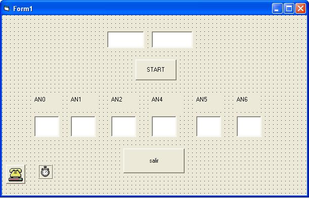

I have a problem with the ADC, the microcontroller PIC16F877A, I'm using 6 analog inputs, AN0, AN1, AN2, AN4, AN5 and AN6, and use AN3 VREF + which is connected to 5Vdc.
4 analog input has a 10K potentiometer, which sends a 0 - 5Vdc. PIC's ADC converts the digital signal input selected and then sends that value for serial port in visual basic 6 program is the formula to convert to the corresponding analog value.
My problem is that there are two entries that have nothing plugged in, and should read 0 volts, but the PC when it displays the information in these channels put random values. also happens when I send 0 volts potentiometers.
also the maximum value that can appear is 5V, and sometimes appears 7.
Another problem is off the microcontroller and the PC sends a data through the serial port, the power LED flashes.

The question is very vague... From your description the PC program is at fault, however we do not know what your passing to the PC from the micro.. this may be a signed / unsigned problem.. I need to see both parts of the code..

and the visual basic project, there is the Start button that sends the micro to start sending data, when pressed sends the byte H22 is valid data byte, and then the data value H48 is the first channel AN0, so the PIC starts to send data.

There is a very strong chance that your sequence can get out of sync.... It would be easier to send the whole string in one or at least send 'A' the L.B ,H.B....'B' L.B, H.B etc... then if a framing or overrun occurs you don't fall out of sync..
then I have to make a communication protocol, as you say:
"A" LB HB "B"
"A": beginning of the message
LB: lower data
HB: upper data
"B" end of message
I will try, if not used Start sequence, he received the data backwards and showed a value High.
Thanks guys, I found what was the problem, the problem was a bad connection, I was not putting the analog signals in the respective channels, and then when the channels are connected have nothing random reads between 0 and 3.4 volts.
Since the project is fine, but now I have a problem, when under the value of the potentiometer to produce 0 volts, minimum resistance to the corresponding channel starts to generate random values. If the ohmic value rises begins to function well. I think putting an op-amp voltage follower mode between the potentiometer and the analog input impedance of the circuit better.
