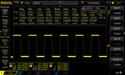

Here's a QuickPrint of the screen:
I am still in the early stages of learning this scope. I pressed "Measure" and the top half of the screen was filled with various settings. How do I return to the full screen? Repressing the Measure button, Menu button, and every other button I could find didn't return to the full screen. The manual doesn't address it, nor could I find it on a Google search. Turning power off and rebooting didn't help either.

Have you tried the "Clear" button?

What does the 'All items - Delete' button, in the bottom right corner of the screen, do?
Tried both clear and all items delete. No joy. Clear clears the trace. The manual implies that pressing Menu returns to the full screen. That didn't work either.

Is the 1054Z one of the scopes that only closes the menu if you hold in the menu button?
Holding didn't work. Rigol Tech Service did reply.
You hit measure again. About half-way down the screen on the right is Measure All, the choices are on and off. Toggle to off and it is gone. How obvious. I wish the manual had a listing of all the menus.
