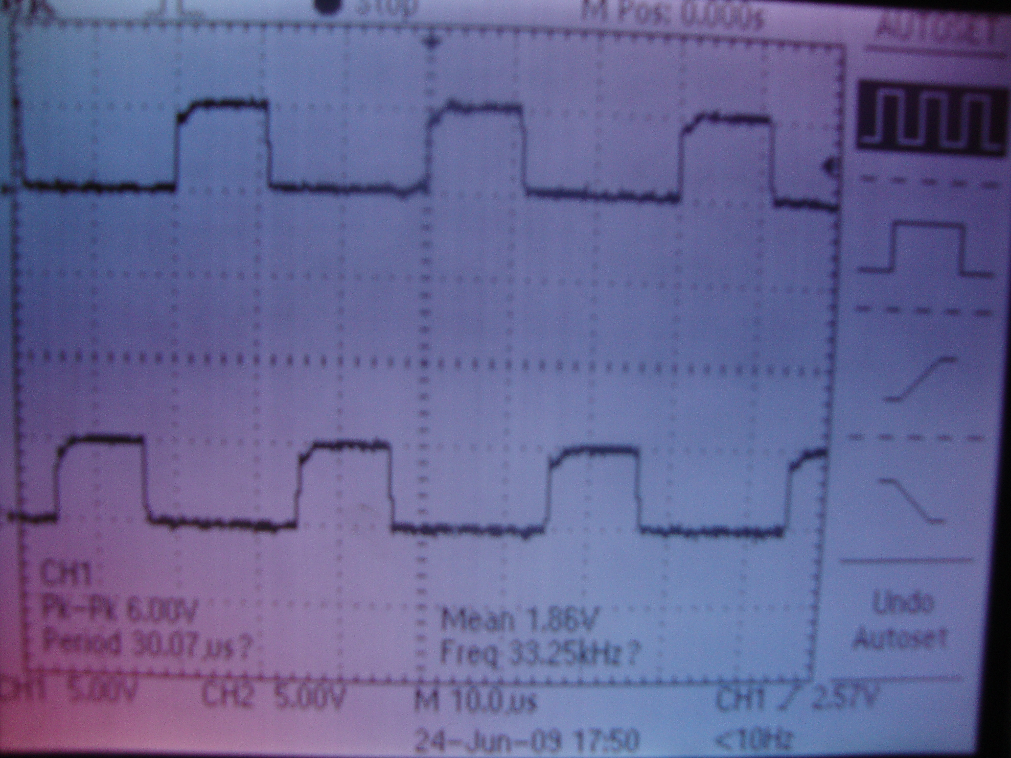

I pulled out a 12f675 and tried it you get a fast toggle if it is low on GPIO,0 and a slow toggle if it is high on GPIO,0 .
You'll want to change the delays to suite your timing here i did it with longer delays so you can see it work

This has 6us ans 12us delays for low and 10us and 20 for high

BUT this works perfectly well when the input on the GPIO,0 is high or it is low
WHAT i actually need is that the input when it is more than 0 volts(NOT HIGH), which could be 1 volt or 2 volt which in digital language is recorded as low, it should toggle the pins GPIO, 1 and GPIO, 2 with 10us for high and 20us as low
AND when the input is 0 volts it should toggle the pins GPIO, 1 and GPIO, 2 with 6us for high and 12us as low.
So the internal comparator use is required in this application where the comparator has to compare the GPIO, 0 input with 0 volts which i am actually not sure how to use.
SO PLEASE HELP !

Suggestions are greatly welcome !

In my application i cant use the opamp as the input voltage is not constant, it varies from 1 v to 4 v so i am left with no other option than to use ADC. Can u tell me how this can be done with ADC.
When the input is 0 v the output at GP1 and 2 should produce an alternate on/off pulse whose ON time is 5us and OFF time of 15us.
Otherwise the output at GP1 and 2 should produce an alternate on/off pulse whose ON time is 10us and OFF time of 20us.
Moreover since the duty cycle is not 50%
so when the GP1 is ON for the first time for 5us and after that it goes off for 15us, at that moment GP2 should not go ON immediately but after 5us it should go ON for
5us and OFF while the GP1 completes its cycle such that the pulses remain synchroized with each other.
And same thing with 10us and 20us
I am attaching an image from the oscilloscope of the pulse. Please see to it
Some1 please provide the schematic to this
This pulse generation part i have finished. Please tell me if it is correct
