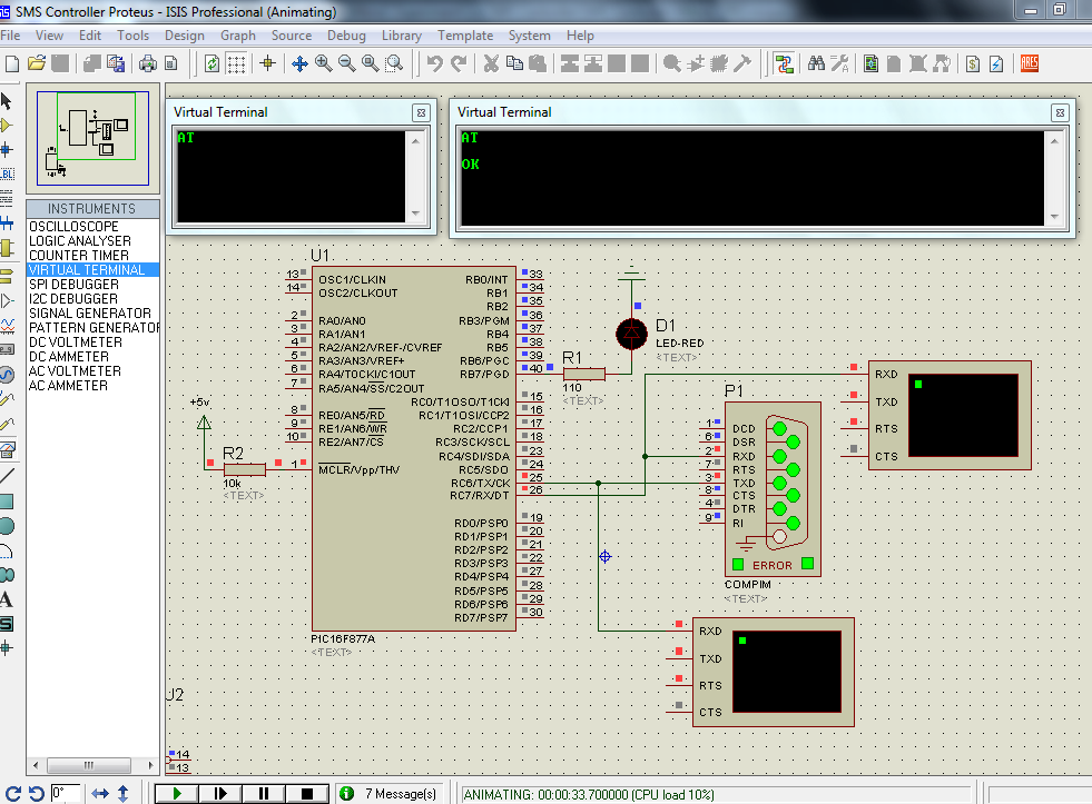

I tried AT commands on hyperterminal and they have no problem. I have written a program and it just can't receive the character 'O' or even 'K' on its uart1_read(). I don't know if it's because of the phone or because of the simulation. I checked everything by virtual terminal using Proteus and the phone used is T68i ericsson. The format allowed only is in PDU.
Thanks ericgibbs for the reply. In mikroc \r is carriage return. You can see it on the image I attached that I was able to receive an "OK" response :) Can you help me further?

Get rid of the delay and check for both characters. Something like,
    uart1_write_text("AT\r");    // Send "AT" and press enter
    [COLOR="red"]//  delay_ms(2000); No delay!![/COLOR]
    i = 0;
    do {
          while(!UART1_Data_Ready()) {
          ; // just wait here until a char appears
        old = UART1_Read();
        rec[i++] = old;
    } [COLOR="red"]while ((rec[i-2]!='O')&&(rec[i-1]!='K''));[/COLOR]
    portb = 0xff;   // Flash LEDs
One other issue is that you can't guarantee that the buffer is clear when your program sends "AT". Just connecting the cable often adds some spurious characters,
