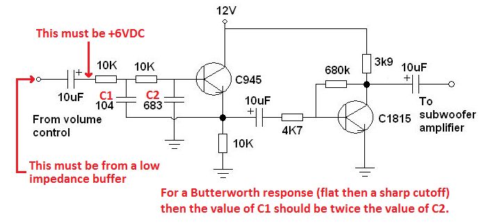

Problem of subwoofer amplifier

An opamp has MUCH less distortion than a transistor. Your first transistor is not biased so it will not work. An opamp would also need to be biased then it would not need a dual polarity supply. I made remarks about your errors:
