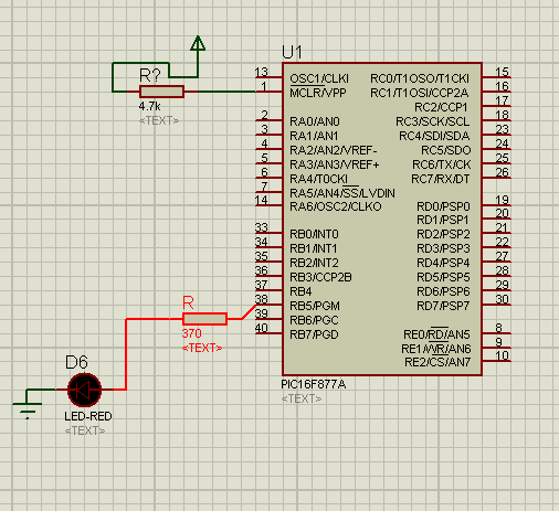

i wrote a program in mikro c & put it into 16f877a, led didnt glow but when i touch one of the probe of multimeter with vdd pin of controller & other with osc2 then it was glowing, what is this?
please tell where i m making mistake??
code is
void main() {
TRISB = 0; // TO MAKE ALL PORT OUTPUT
     PORTB = 0; // TO OFF PORTB
     while(1)
     PORTB = 0xff; // TO TOGGLE PORTB
thanks & regards
hassan khan
I have noticed that you are doing nothing in your code.... To toggle the port you should use..
PORTB =~PORTB;
If your circuit is the same as this (with a crystal) it should work..... On a side note.. What speed is your crystal....... If it's 4mhz or below, you need to specify XT crystal setting in your IDE before compilation... If its above, you need to specify HS
yeah its 4mhz,& i have made that before compilation
