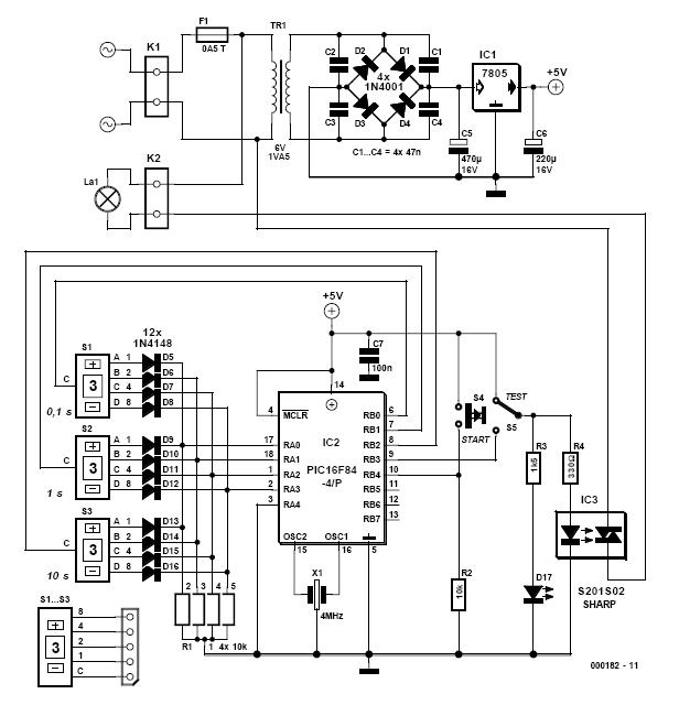

I'm attempting to build the Darkroom timer from the April 2001 edition of Eleckor Electronics but have hit a bit of a snag.
I'm having trouble obtaining IC3 which is an Opto Triac S201S01 (Sharp) (Conrad # 16 81 65)
Anyone know of a substitute for this. I've gone to the Conrad website but the available of it is 'Red'

Hi Folks..
It looks like I may have hit a dead end in finding a replacement for the S201S01 Opto-Triac.
Could a kind soul take a look at the attached file and possibly recommend a way around the problem. The problematic chip is IC3.

The way I'd do it, would be to use a relay. Driven from the pic via a suitable transistor and back-emf diode.
Alternatively, download the spec sheet of the S201S01 and try to find a similar valued one (that is available), in the same sized package.
What sort of output current do you require?
I would normally use the MOC3041 but if I needed more current I'd add another buffer triac.

Hi Declan,
by chance I discovered your trouble for looking after a solid state relay. I have a similar, pin compatible unit named S202S02 available, which is "the big brother" of the s201s01, capable of switching up to 8 Amps @ 250V 50/60Hz
The pinning an mechanical size is equivalent to the pdf you posted for the s201s05, so I think, this should be suitable for your needs. No change of circuit, PCB, etc.
The S202S02 has zero crossing detection built in, but I think this won't be any problem for this application, since you just switch 100% on or off, as I understand.
I have some of these available, if there is interest, send me a personal message with your needs.
Kind regards
Andreas

I've posted a PM to you. One thing that slipped by me is that if you look at the PDF for the Project, it marks IC3 as S201S02 in the circuit diagram but in the component list, it is marked as S201S01.
I'm now wondering which one is correct and based on this, which substitute do I use?
If only I could get my hands on the datasheet for the S201S01.
It seems from trawling the internet the that the following are alternatives:
S201S05 for the S201S01 and the S201S06 for the S201S02

Hi Declan,
you've got PM too.
Looking at the Elektor circuit I've seen that discrepancy too, but to my understanding both versions can be used.
S201S01 is the SSR (solid state relay) without zero cross detection while S201S02 includes zero crossing detection.
The zero cross detection controls the switching or "firing" of the main triac (inside the SSR) shortly after the zero crossing of the mains voltage. This reduces electrical noise (disturbances, EMC etc) of the circuit so you don't need to synchronize the SSR control voltage with the mains frequency.
On the other hand this behaviour prevents the use of the SSR for phase control applications like dimmers, for those you need to use the S01 version.
Coming back to your darkroom application I think there is no need for mains phase control since you just want the lamp being switched fully on or off, no dimming or any other power control is needed. Both the S01 and S02 versions can do the job. The PIC will just leave the control output on for the desired duration set by the switches, and this will be in the range of seconds to minutes, as I understand the use of the timer.
