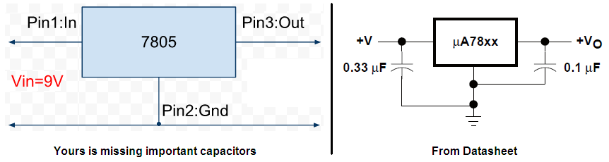

i connect 7805 regulator with 9V battery and power supply separately.
but the output voltages are different..
Result: Vout(9V battery)=~7V; Vout[power supply(9V)]=~5V
You need to place decoupling capacitors across pins 1-2 and 2-3 and drive an actual load with it before it will regulate the voltage.
100-220uF and 100nF capacitors on both sides is usually fine for decoupling.
Read the datasheet for the 78xx series regulators and you will understand what's going on...
i have tried to adding cap. on both sides, but the result is the same. is the function of the cap.s is to lower noise?
i cant get 5V with batteries, but power supply does, it leads a question that what are difference between power supply and batteries?

You 9V battery must have a high ESR, try changing brands or a fresh battery. Either way it won't last very long on a 7805 with a Bluetooth device attached.
The function of the caps is to make it work, it's VERY likely to be unstable without them, and you should never leave them out. The fact that it's too high a voltage means it's unstable.

The datasheet shows the very important capacitors. They must be connected very close to the regulator with very short leads. they prevent the IC from oscillating.
