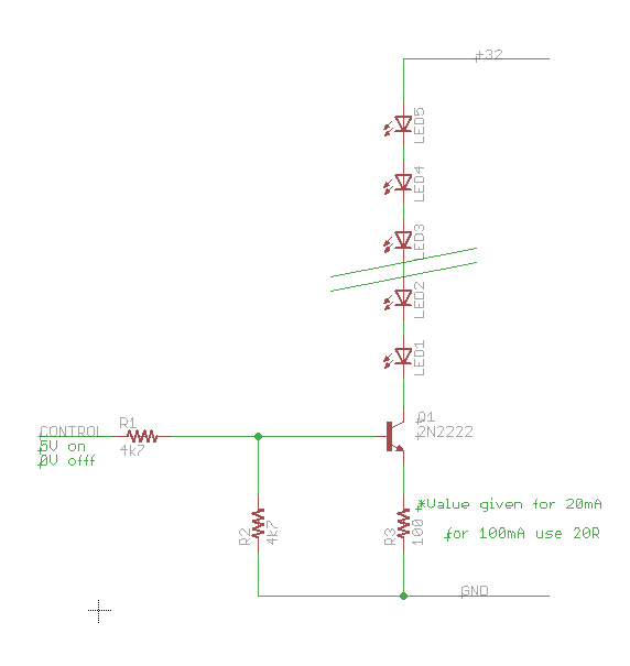

I am build an overtank lumminaire for my aquarium, and it will take some 360 leds, as follows:
Power supply 32V 1,5A
6 strings 10 leds each, at 98-100 mA each - 6 LM317L in current regulation
30 strings 10 leds each, at 19-20 mA each - 30 LM317L in current regulation
So, stupid question nr. 1:
Can a commom resistor set the current for a number of LM317Ls, i.e., for the ones regulating current at 20 mA, one single resistor...?

Hi Daniel,
each LM317L must be treated as one device with it's current feedback resistor, so you need a current feedback resistor for each regulator.
The reference resistor (Rf) is calculated by: Rf(Ω)=Vref(V)/Iref(A),
where Rf is the feedback resistor value(Ω), Vref is the IC reference voltage (nominal 1.25V) and Iref(A) is the desired constant current.
For 0.098A constant current the formula is Rf=1.25V/0.098V; Rf=~12.76Ω
Vref might vary individually from 1.2 to 1.3V, nominal Rref is 1.25V.
for tight tolerance (98mA) it is advisable to measure the actual current flow and adjust Rref accordingly.

If you plan to control them with Arduino, you don't really need LM317s. In the example below, I assumed the Arduino is running at 5V. Use one circuit for each string. If your Arduino is running on 3.3V, change R1 to 680 ohms. I have not tried this on the bench, it may require 18R for 100mA.
(Note: Some sharp eyes will notice that I'm using a gain of much more than 10. That's because the transistor isn't saturated.)
