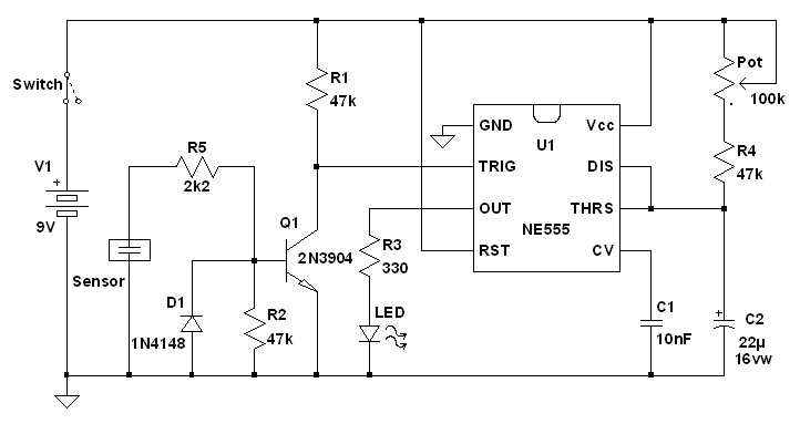

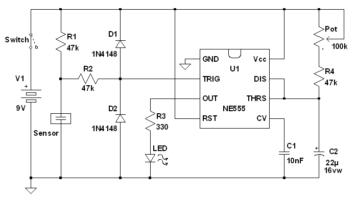

In that case the output voltage of the sensor will probably be great enough to trigger the 555 directly. In fact, it would be advisable to use diodes to clamp the 555's trigger input to the supply rails and so protect the 555 from over-voltage, since piezo sensors can output tens of volts when hit hard.
Here are a couple of suggested circuits based on the one in Ian's link (post #13).
The first should be suitable if the sensor output is several volts for the sort of impact envisaged.
The second includes an amplifying stage to boost the sensor output if it is only 1V or so.
The potentiometer allows adjustment of the LED 'on' time from ~1s to ~3s. R4 or C2 could be increased in value if the 'on' time needed to be increased. The two leads of the sensor may need to be swapped over, depending on the polarity of the pulse it outputs.
The first schematic above looks correct. But I believe the sensor on the second schematic should go to B+ instead of B-.
But then a 1V signal would not trigger the circuit. N.b. the polarity of the sensor in the second circuit needs to be the reverse of what it is in the first.
