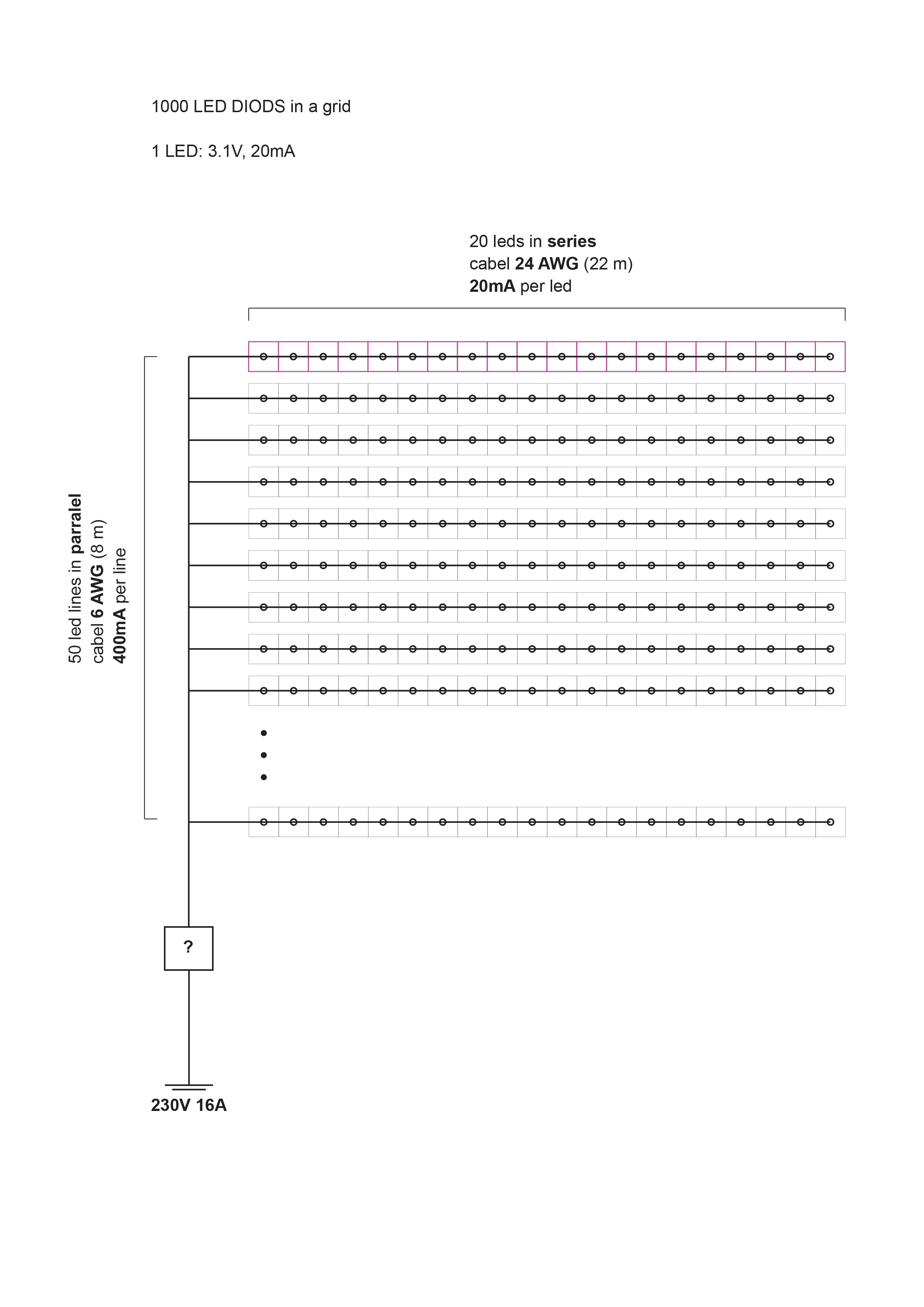

Hello, I am making a light installation of 1000 leds in a grid 20x50 leds. I want to connect 20 leds in a series and then connect each series in parallel (50 lines in total). Each led is about 3.1V 20mA. Can anyone help me with what adapter I would use to power this? (I have a regular EU plug 230V 16A). And do I need to put resistors? And where? Final question, because of the design restrictions I can fit max of 24awg cables in the series part of the installation, but I can put any size of a cable between the lines - for the parallel connection. What size of a cable would I use? I hope someone finds this possible and challenging enough to help me out.

3.1 volt X 20 = 62 volts (more or less)
20mA x 50 = 1000mA = 1A
Why not use 1A 3.1 volt LEDs? or 300mA? Why not bigger LEDs?
The text "400mA per line" is wrong. It is 20mA.
Rightmost LEDS must be connected together in the column to power return.
"?" should be about 62 V capable of at least 1A as told above, not 230/16A
Correct. Seems he is not discerning 230V mains being AC and LEDs need DC. The bottommost symbol could be a DC voltage source missing connection to missing rightmost column connection. Perhaps the '?' is for the OP, a questioned resistor.
The "6AWG cable" is way out of whack. 24AWG everywhere is fine.

Interesting solution. Do you know if 24awg cable work at length 66m? (each led is 1m away of the other. They are in 1m tubes sticking out, and max 24 awg cable fits in the tube). I am worried about voltage drop.
The resistance of 66m of 24awg is about 5.5Ω so nothing to worry about. Total voltage drop 5.5x0.02 = 0.11V.

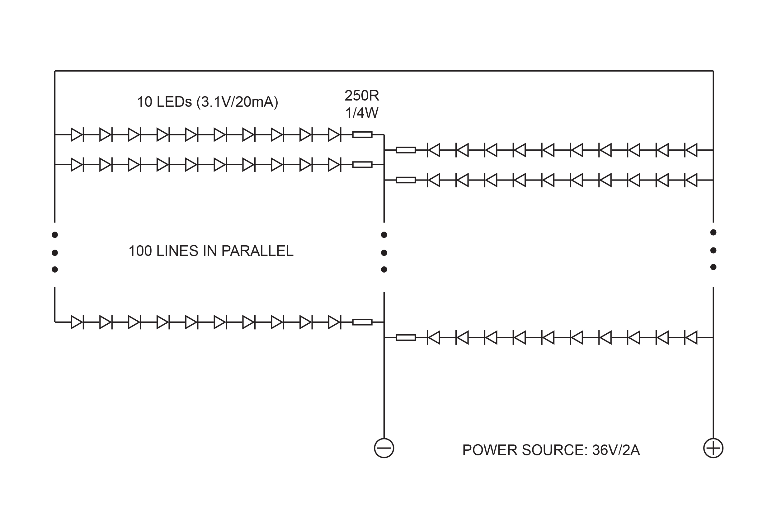

Agree completely. Personally i wouldn't have more than 48V and have 70 strings with 14 LEDs per string. That would only require 1.4A and would be much safer. A suitable power supply can be had on ebay for around $20.
Edit, as you need a grid of 50x20 I'd do 100 strings with 10 LEDs in each powered from 36V. This would require 2A - quick look on ebay finds this which should be safe.
I am glad you are saying that. After some consideration, even though it's completely out of the reach of people, I decided to stay under 48V. I'll do 15leds in line with a 390R 1W resistor. Then connect the lines in parallel to 48V/1.5A power source. I hope my calcs are correct. Thank you all for your help!
If you do 15 LEDs per line then 15*3.1 is 46.5. This only gives you 1.5V to regulate current (BTW, 1.5/0.02=75Ω).
That is why I suggested 10 and 36V as this gives you 5V overhead and a resistor of 250Ω.
Note that the power is V * I so 5*0.02 = 0.1W - so 1/4W resistors will be fine.
Yes, that's correct. However, in the link to the power supply above a 2A supply is $20 and a 5A is $24 - for the extra $4 and increased flexibility I'd get a higher current supply.
