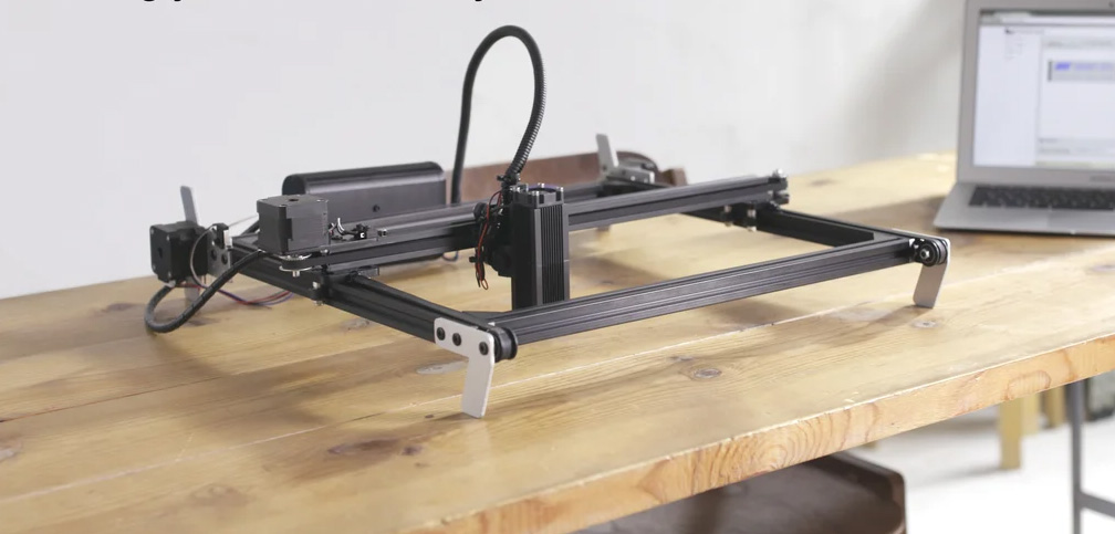

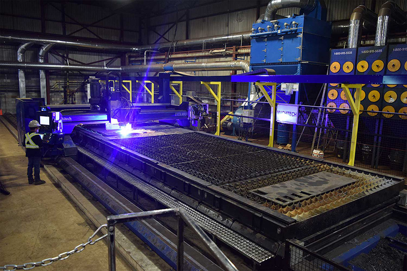

The point I'm trying to get across is that the appropriate parts and sources, both drive system and mechanical such as leadscrews and rails are totally different between a very machine and a large machine - and you have not given anyone the slightest clue what size of machine you are looking to build!
Is it this size?
Or this size?
I'd guess somewhere in between, but where???
