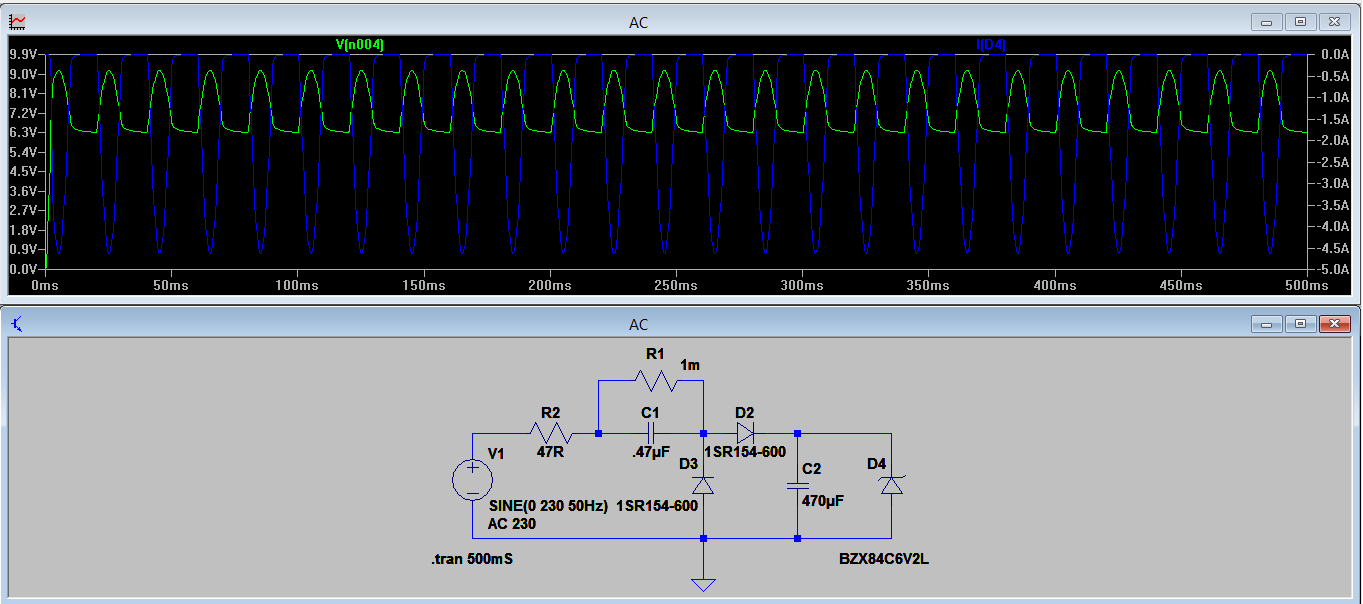

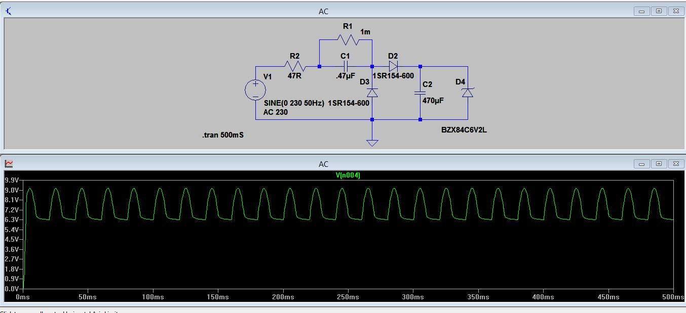

How can this output voltage go beyond 6.2V? If there is a zenner diode...!!
You have 5A at 9V (45W) in a device rated at 300mW. The resistance of the device at that current isn't even in the datasheet.
Don't you think 4.7A is a little excessive for a 250mW diode? o_O
In real life that zener would be smoke. :eek:
Back to the drawing board. :D

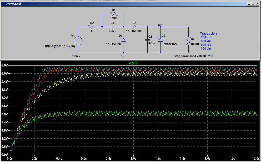

For starters, make R1 = 1Meg (1000000) Ohms, instead of 1m (0.001) Ohms. In Spice, little m is milli, while Meg is mega... Also, Sine Voltage sources are specified in peak Volts, not RMS, so you have to multiply 230*1.414. I love {} curly braces...
Here it is again, with the first order problems fixed. I also wanted to see how much current can be delivered by this off-line power supply, so I added a stepped resistive load of 200, 400, 600, and 800Ω. Note it does ok at 200Ω to 600Ω, but a load of 800Ω is questionable.

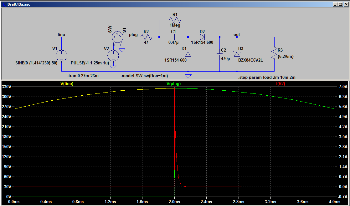

The next potential problem to check is what happens if you plug in this supply at the instant that the line voltage is at its peak value of ~330V. Here I show the peak in-rush current if the switch is closed at the worst possible time. Will R2, C1, and D2 stand occasional 7A peak currents?
At what time would you close the switch to check the peak current through D1? What is max peak current that could occur?
Simulation is very useful to answer questions about a circuit. You have to learn the tool to make it work for you, and you also have to subject the simulated results to a smell test. For example, it is obvious (to me at least) why the Zener current was too high GIGO ...
Attached are the two running simulations...

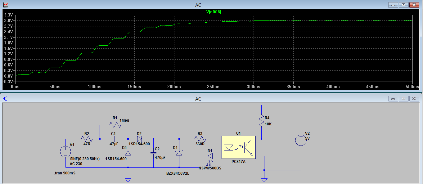

Actually I need to check the 230V power is available or not & take an isolated signal to another circuit.Attached the final diagram.
In this case the maximum load will be LED load, that is 10mA. Is this load enough for the circuit..!!!

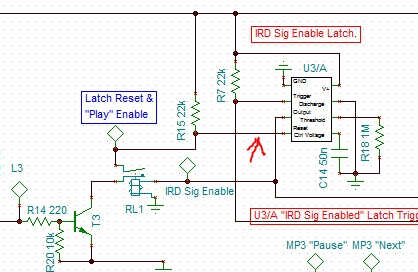

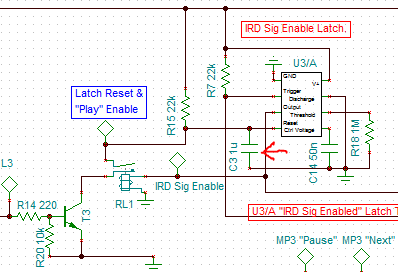

Did a SIM (TINA TI) of a 555 Latch that worked "perfectly" with the circuit as below (note arrow on "Reset" line):
On real life breadboard, the latch did not always reset.
Added a cap on the breadboard to the "Reset" pin:
And all was well.
As Ian counsels:
... As soon as I have something, I'll build and test!! ...
Sound advice.
