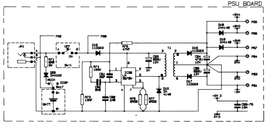

Being new to all this and at the lower end of the "steep" learning curve I found the diagram for JK1 confusing, as the V shaped connection I would assume to be the ouside contact of the plug but it is connected to the positive side of the battery ??

No, the V shaped part on the schematic connects to the positive tip or center on the plug. The bar shape connects to the part of the plug barrel closest to the plug self-lead (0V). The circuit symbol is confusing.
I am not convinced, and will wear sack cloth and ashes if I am wrong, but,
I think that the V shaped bit contacts the outer sleeve of the connector, and the "Bar" is the pin which enters the barrel of the plug.

Agree, but going by the PSU circuit diagram the center or tip is positive
I am not convinced, and will wear sack cloth and ashes if I am wrong, but, I think that the V shaped bit contacts the outer sleeve of the connector, and the "Bar" is the pin which enters the barrel of the plug.
It depends if the connector is a jack or barrel.
On a jack, the V can either engage in the indentation at the back of the tip or on the main barrel.
With the barrel the V can only contact the outside barrel but that is physically; the contacts can be isolated.

Why don't you simply open up the case of your TD201 and have a look?
Use a multimeter to measure what is on the terminals as they are?
Looking at the PSU schematic which spec has provided, the -ve side of the battery connects to one of the connector terminals. Check it out.

Don't worry. I am pretty sure I am right, but in any case it wont matter if the polarity is reversed, you won't do any damage because there are two diodes in the PSU to protect against reverse connection. If you could tell us what connector you have: jack or barrel, that would be a big help. Can you take a large picture of the power connector on the instrument.

There are four batteries in a carrier, they are used to retain the data in memory.
The power connector is of the barrel type but a little bit smaller in diameter than the most popular ones.
The multimeter shows the negative side of the battery is connected to the central pin of the socket and the positive is connected to the side sleeve of the socket.
So I need a power supply 9V 1amp with a negative central socket of the plug, is that correct ?
From what you have measured, yes but that does not accord with the circuit diagram. Your best bet is to get a PSU that can be switched betwen positive and negative inner. You can also get a PSU with a wide range of connectors. I will have a look for a suitable unit
At the risk of being controversial, I think it ties up exactly with the (ambiguous) circuit diagram.
The user instructions leave a lot to be desired, the instrument is portable and can be powered by four C size batteries, the batteries can be either disposable or rechargeable, and there is a selector switch on the rear.
The instrument may be powered by an approved AC adapter/charger.
If using rechargeable batteries and the selector switch set to rechargeable the power supply will recharge the batteries at a rate of 170mA.
If using disposable batteries and the selector is set to disposable inserting the power jack will automatically disconnect the batteries.
I have seen the light. Nice one Jim. :banghead: Please send sack cloth and ashes.
Ahh, I was wondering what the DISP annotation was about next to one of the switches in the schematic.
