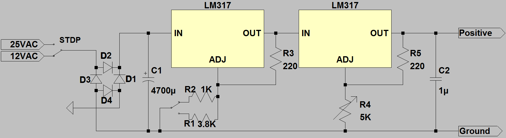

Ok, I just finished coming up with a new design (see attachment).
With this, the first regulator has two set output voltages, one around 22V and the other around 6.5V. This takes some strain off of the second regulator. I've calculated and believe the maximum power that would ever be dissipated by one regulator at 1.5A would be about 14.55W. So, that way I can use a 5°C/W heat sink on each LM317k and be able to get max amperage out at all voltages from 1.25V-30V. So the question is, will it work like I think it will?

An LM317 is supposed to have a 120 ohms resistor (not 220 ohms) from its output to its ADJ pin to prevent the output voltage from rising without a load. A more expensive LM117 can use a 240 ohm resistor.
The second regulator needs a capacitor to ground at its input to prevent it from oscillating.
EDIT: Your voltage calculations are wrong.
The first LM317 has an output that is 6.93V and 22.84V. Then the second LM317 will have a max output of 4.93V and 20.84V.
The 5k pot will have most of its rotation unuseable.
So it has to be exactly 120 or could it be lower? What if I wanted to use one that is 100ohm so I could use a more common 2.5k pot?
How large...?
I know the voltages were just a guess from an earlier calculation I didn't write down. I also forgot to add in a switch to bypass the first regulator to get the remaining range up to 30V. Yes the pot will have a lot of unused rotation when the input of the second regulator is dropped down by the first one.... but there wasn't really any other way to do it...
It can have a value lower than 120 ohms but then the current is higher and the pot might burn up.
How large...?
It is shown in the datasheet. Don't you have the datasheet?
True....
Yeah, 0.1uF I guess...
