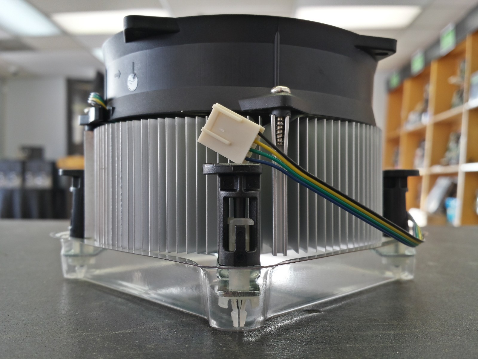

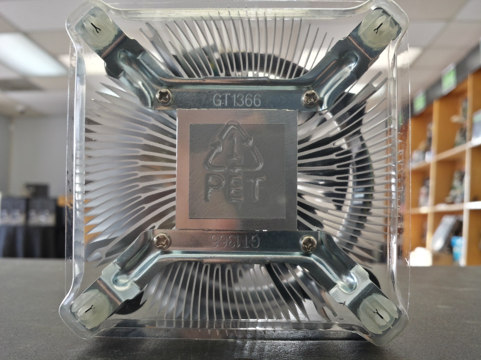

The 3 ounce heat sinks heat up to 120 degrees in 2 minutes so I am thinking about replacing them both with 2 CPU heat sinks with fans to keep the mosfets cool. I will need to extend the mosfet wired 1" longer I hope that is not a problem for the LC circuit?
