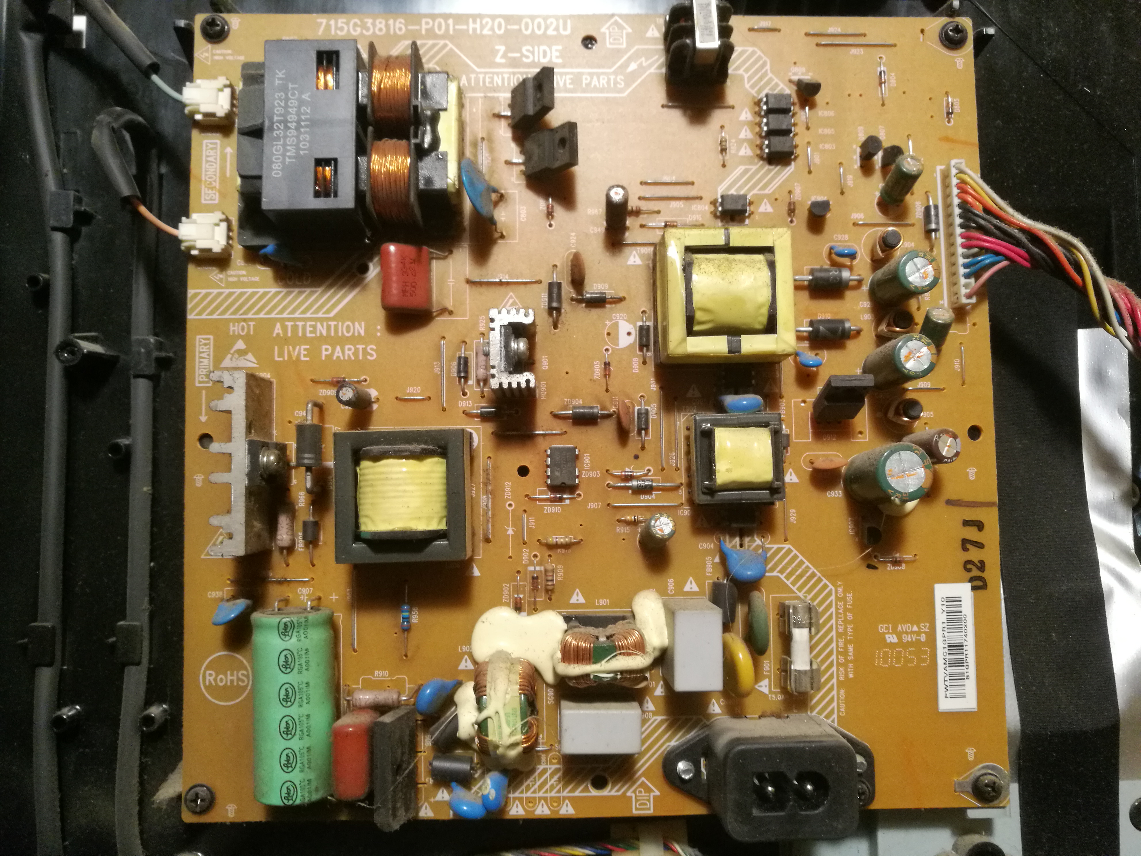

Hi guys! I'm trying to fix two devices: one is a TV, one is a guitar amplifier.
The problem is that they stay on for some time and then go off. In both of them we narrowed down the problem to the power board, which is making a strange buzzing sound (when on) that apparently comes from the transformer!
I'm guessing it's because of a condensator but don't know about mosfets or something like that. Everything looks good, no evidence of damage in both cases.

What Models are they? Do you have schematics? How old? How many Capacitors? Send photo of suspected boards.
Testing caps the way you suggest may not lead to any usable results. Hum is usually from AC ripple traveling thru the cap while still blocking dc and rising to proper voltage.
Next if there are not too many caps then you might consider replacing them all as caps have a limited life span compared to other electronic parts. If there are many then a proper "ESR and Capacitance test should be done. Did both units fail at the same time (voltage surge?)

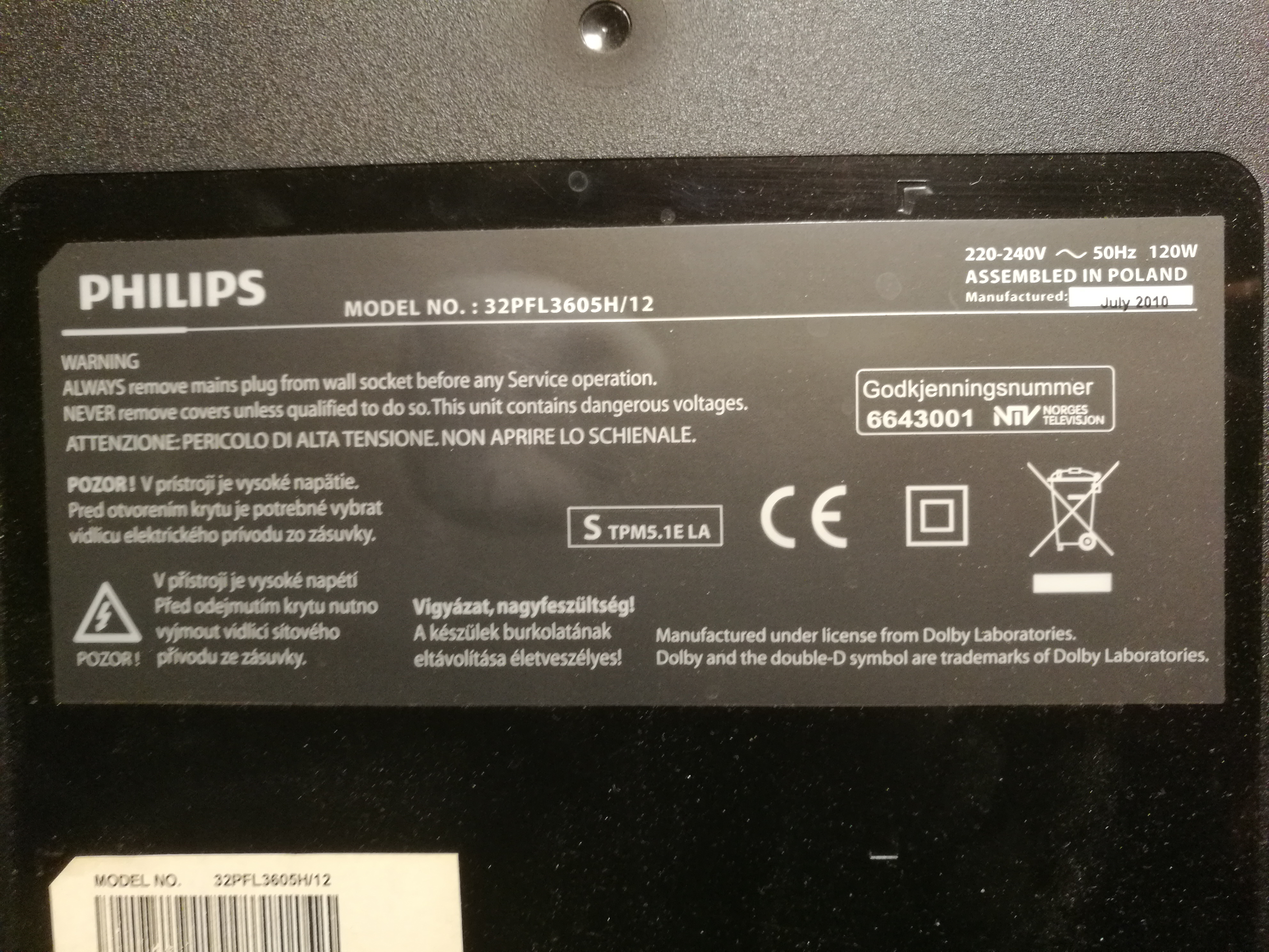

Thanks all of you! The TV is not so recent. It's a Philips model 32PFL3605H/12.
It stays on for some time and it shuts off. I guessed buzzing was involved because it's not the first time it happens.

However here are the pics!

Check the voltages coming out the PSU, there should be 5V when it's on, or in standby - then there's 24V and 12V, which are off in standby. This is switched on/off by Q907 through R943, the connection labelled SB - this should be high for ON, low for OFF - so if the 5V is OK, and the other two are missing, check that voltage.
Nothing looks burnt on the board. My guess is it will almost certainly be due to dried out electro caps. The shut down will be due to excessive ripple on the supply rail/s.
