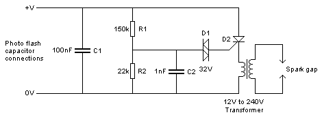

Here's another camera flash related idea.
This one will fire automatically and will repeat if the capacitor charger is the sort which caries on charging, after the flash has been triggered.
Increase C1 for a more powerful spark. Don't go too high otherwise it will ruin the transformer.
R1, R2 and D1 control the voltage at which it fires, in crease the voltage for a longer and more powerful spark. The maximum voltage will depend on the capacitor charger.

thank you very much, but when you mean automatic, like it's continuous and never stops, or just fires once it's charged? sadly that is not what I want (sorry if i'm a bit picky, but have to stick to the project subject). You're other disposable flsh camera idea seems good, however I do not quite understand, can you maybe draw a schematic for me?

Did you notice the schematic attached to my previous post?
It shouldn't make any difference whether the spark is repetitive or continuous because you only need one spark to ignite the gas. Just put a switch in series with the battery powering the disposable camera capacitor charger.
Ok now I understand. Sorry, I'm not very familiar with components. By disposable camera capacitor charger, you mean the camera is supposed to charge the capacitor? If that's so, am I supposed to press the 'capture' button to make a spark.
What is the D1 sign?
