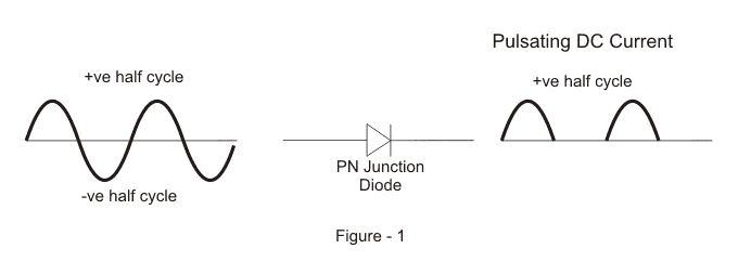

I think the understanding here, is that the next development in glass or metal tubes over here after the triode, was the "traveling wave tube"; which actually was a tube of glass, and the terminology stuck from there on. Boy, I think someone needs to post some kind of a visual, of an AC sine wave converted to pulsating DC by a "half" wave rectifier diode to get the picture! o_O

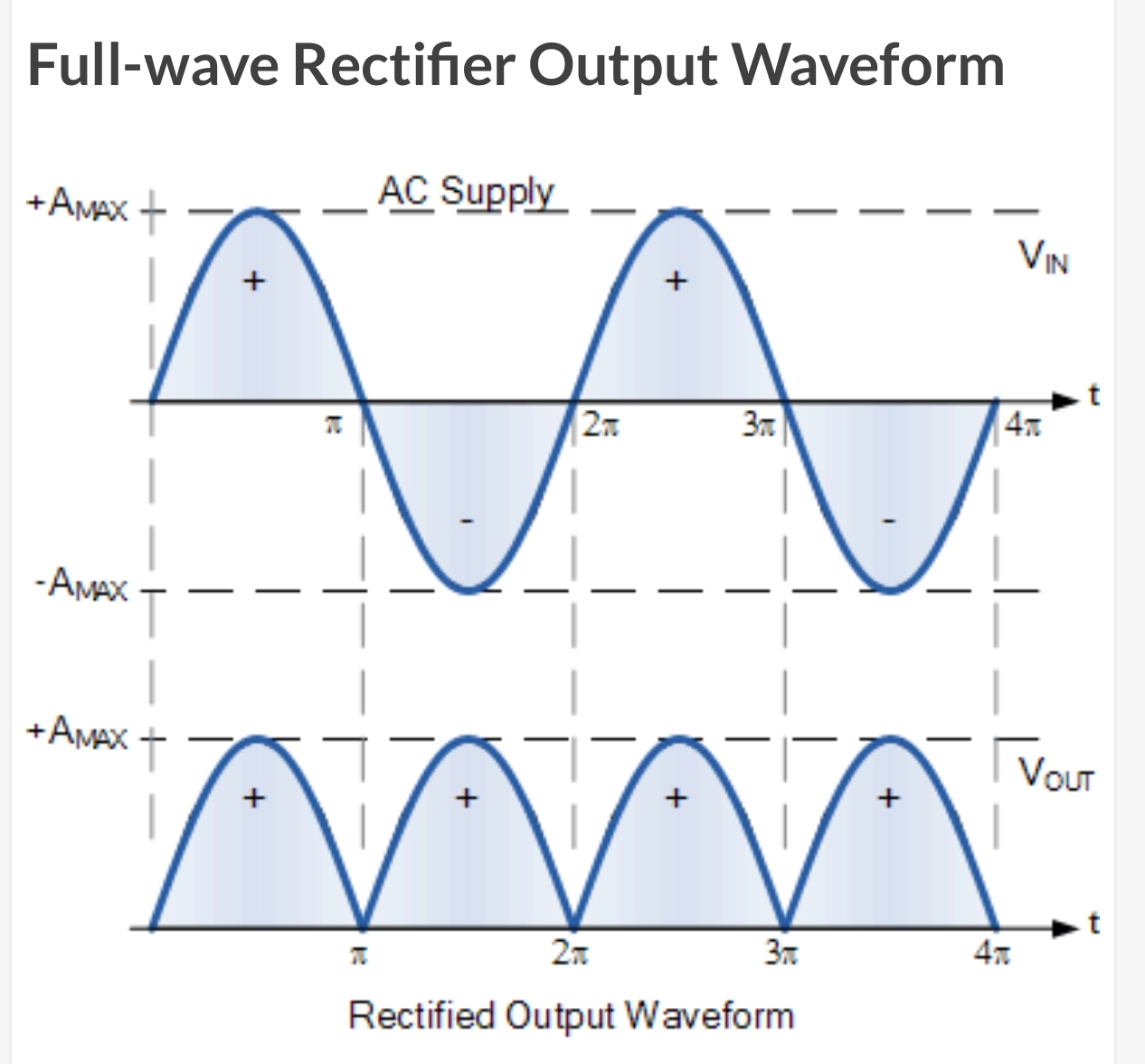

Are you maintaining that the RMS value of a full bridge rectified waveform is different than the RMS value of a sine wave (minus the small loss in the diodes)?
