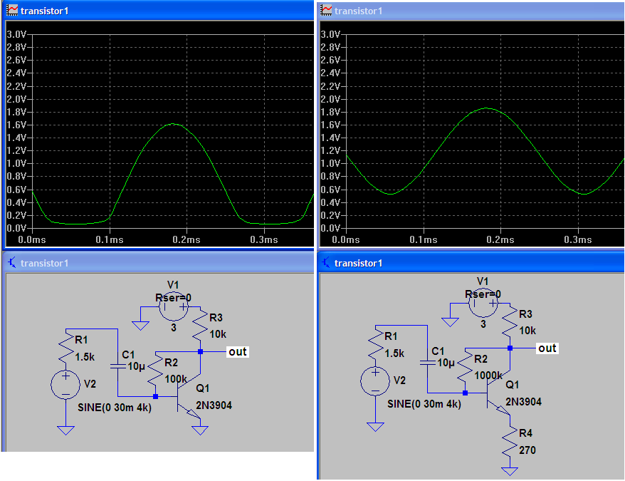

Hero simulated my FM transistor to show how to make it more powerful.
I use Sw-CAD III sim program from Linear Technology (it is free) to simulate other people's horrible designs to show how bad they are.
Here is the mic preamp from somebody's horrible FM transmitter and my fix for it:

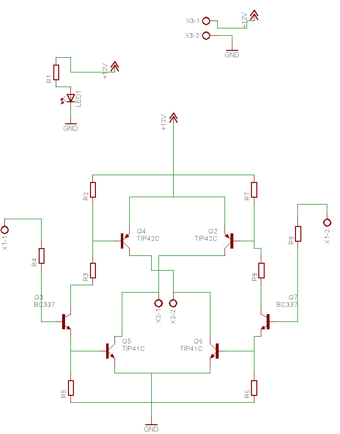

i tested the new H-Bridge but it doen't work well , i noticed that one of the TIP 41 is going too hot .....and the motor work even without any signal.....i'll post you my schematic and tell me why that had happened?
Maybe your motor draws much more than 3A. Measure its resistance. If it is 4 ohms then its max current from 12V is 3A.
Only one signal can be high at a time. If both are high then there will be smoke.
When a signal is at ground then the BC337 is turned off and it turns off the associated TIP41 and TIP42. Therefore when both signals are low then none of the transistors are turned on.

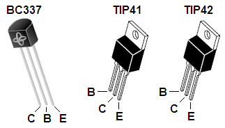

i fixed the transitstors with the right way i'm sure.......but i'm afriad that happned becuse of the LED i added
Your LED is connected to the supply voltage. It doesn't affect the transistors.
1) Does the input signal go to 0V when it is turned off?
2) Does the input signal go up to near +5V when it is turned on?
3) What are the resistor values?
4) Does the motor draw only 3A max? Measure its resistance.
The circuit might need protection diodes across the power transistors.
i'll answer two of your questions now:
1- motor current consumption is so low.less than o.4 A
2- resistor values are , 1 Kohm and 33 ohm and 150 ohm.....is that correct
A motor that uses 0.4A without a load draws 4A or more when it starts, when it is loaded or when it is stalled.
anyway i'll prepare aother PCB may be that is the reason and i'll try a very small motor.

You said that the motor runs without any signal. Then both inputs should be 0V. If the motor runs then a BC337 is conducting when it shouldn't.
