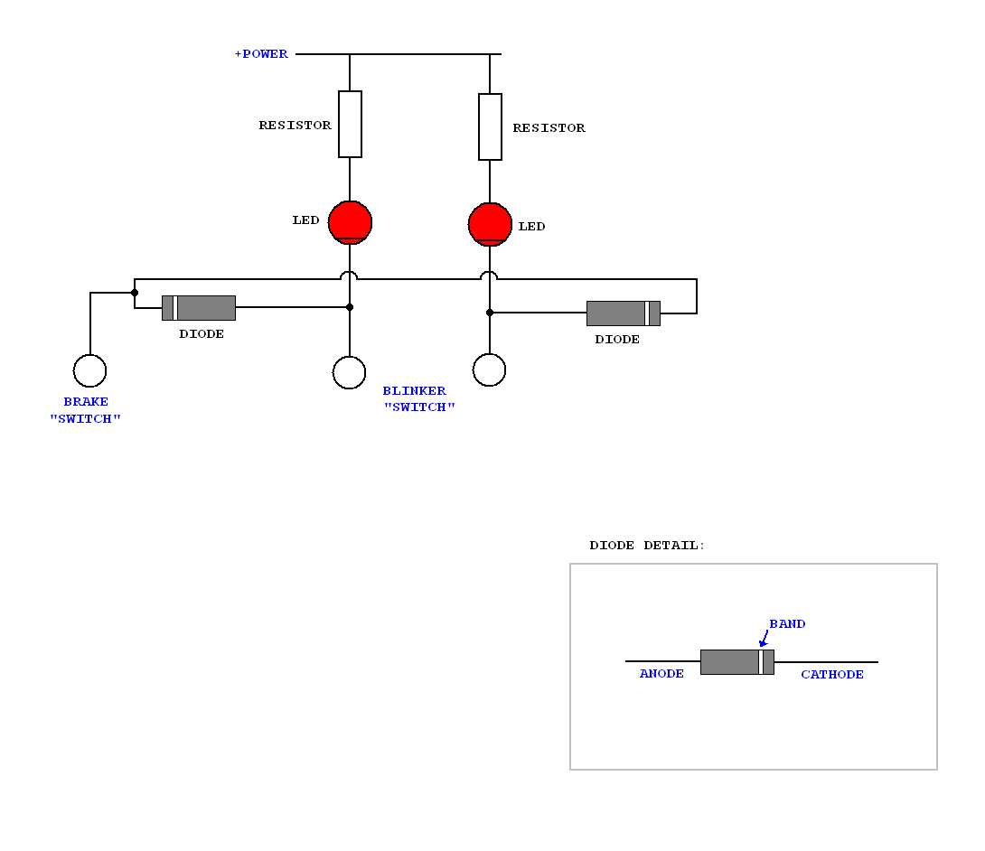

Please I need help building a circuit
And here's a drawing to help with the connection of the diodes and
LEDs and the LED resistors and associated 'switches'...

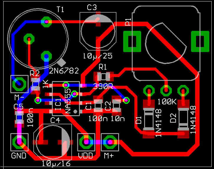

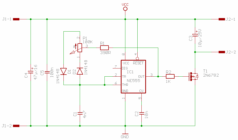

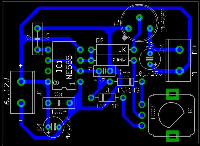

Hi oldman23,

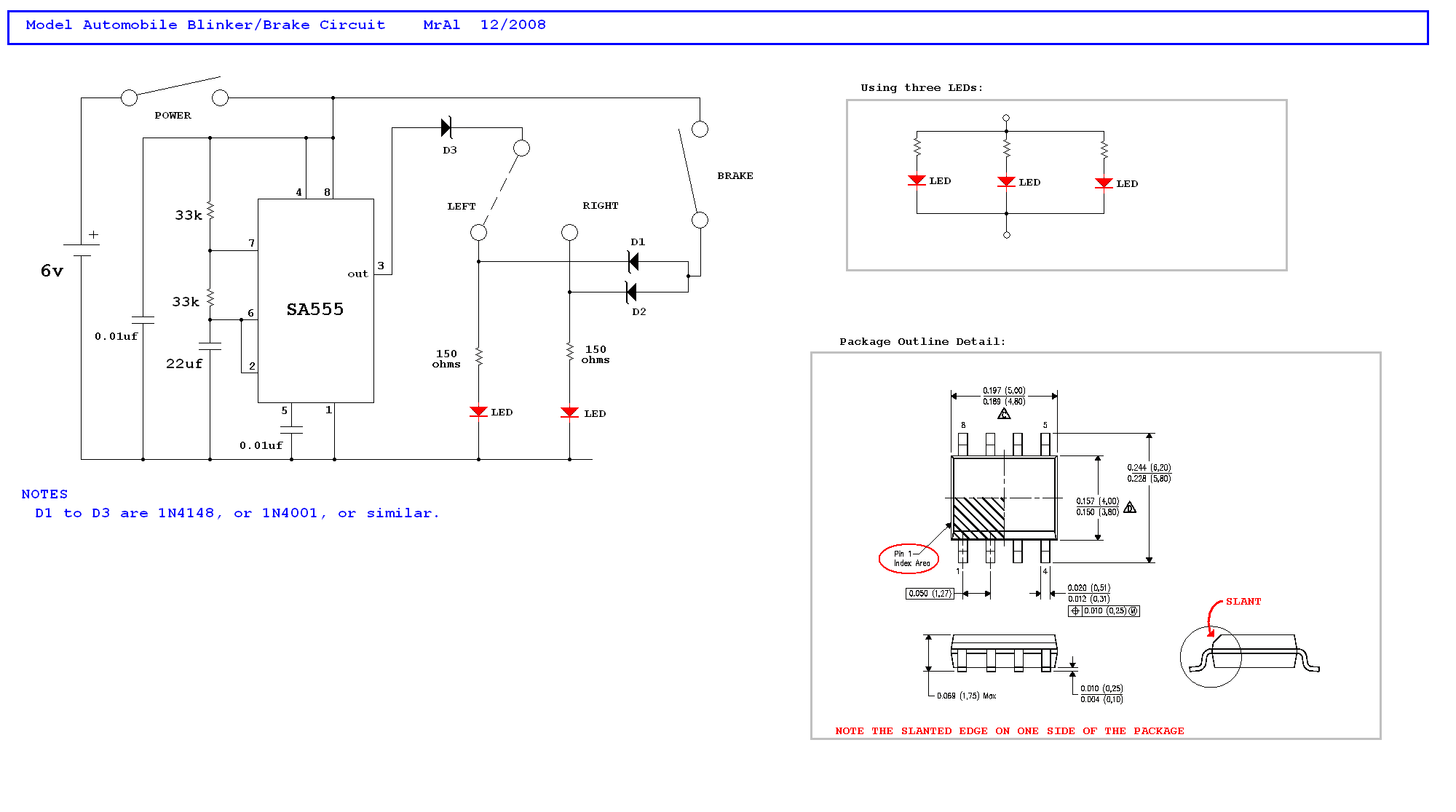

here are schematic and PCP-layout for a car "engine" control circuit. I can be operated from 6V (that's probably what your motor is rated for.) If the motor consumes less than 300mA you might connect it directly to the timer IC output pin, omitting the MosFet transistor.
There are two PCB designs, one using wired components and the other one SMDs to a great deal. However the PCB dimensions don't differ very much in size.
The conventional board is 1.82X1.32inches, and the SMD boad is 1.2X0.96inches.
If you get off the expensive button type batteries you might use a 9V block battery and connect up to three LEDs in series to a constant current source (LM317L). Using that has the advantage of constant current to all LEDs in series with only one resistor (required to determine the amount of current to flow).
Refer to the schematic to find out the pin assignment for the timer IC NE555 (NA555).
Regards
Boncuk

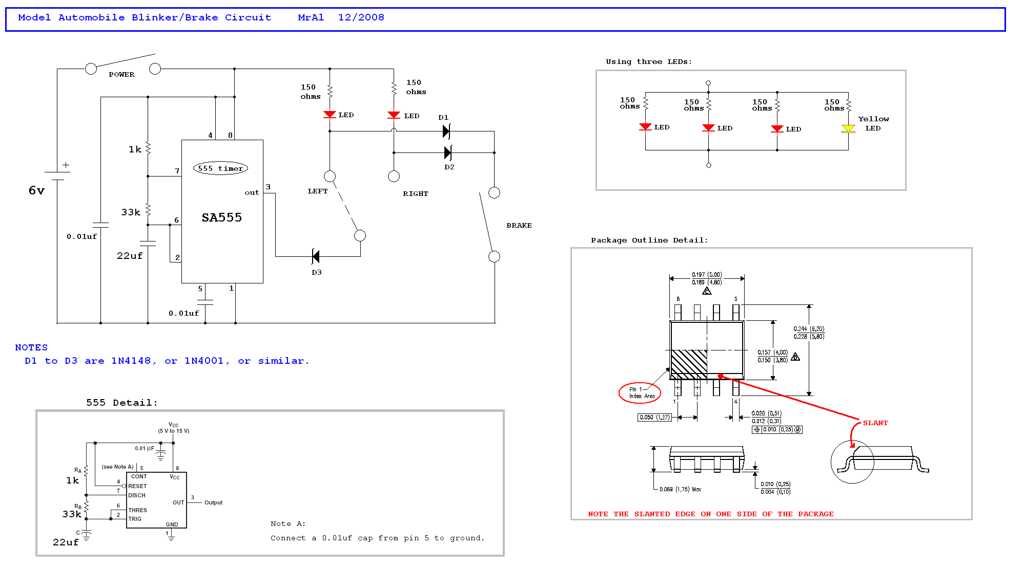

Hi again,
Ok, well just in case you change your mind if you want a blink
rate of 1 second 'on' and 0.5 seconds 'off' then the circuit will
have to change like this...
Note also that if you change the upper 33k resistor to a 1k
you get 0.5 second on and 0.5 second off as before, so it's
up to you which circuit you want to use. This last circuit
allows a longer 'on' time than the first by changing only one
resistor, while the first circuit allows a longer 'off' time by
changing only one resistor.

Hi MrAl again we speak (type)
Thank yo so much I'd like to stay with the first schematic and not change the blink rate. Maybe I'll try it on a different board down the road sometime. Could I bother you to just sketch a the yellow light where it ties into the 3 red Led's. I have short term memory loss and I can read it and go to do it and forget what it said and how to do it. I am slightly handicapped. I'm stuck in a wheel chair and I don't have full use of my hands either so what takes someone 5 minutes to do can take me an hour or more. especially wiring and soldering. I hurt my back in an industrial accident and they done surgery and fused 6 vertebra together and then they done 4 more surgeries to straighten out everything else. Now I have permanent nerve damage in my legs and hands. I use 2 fingers on one hand and one finger on the other. So please bear with me on this stuff I'm not stupid just Dumb. Thank You again for all your help and if you are interested in the aftermarket send me a P.M. and I'll tell you who what and why

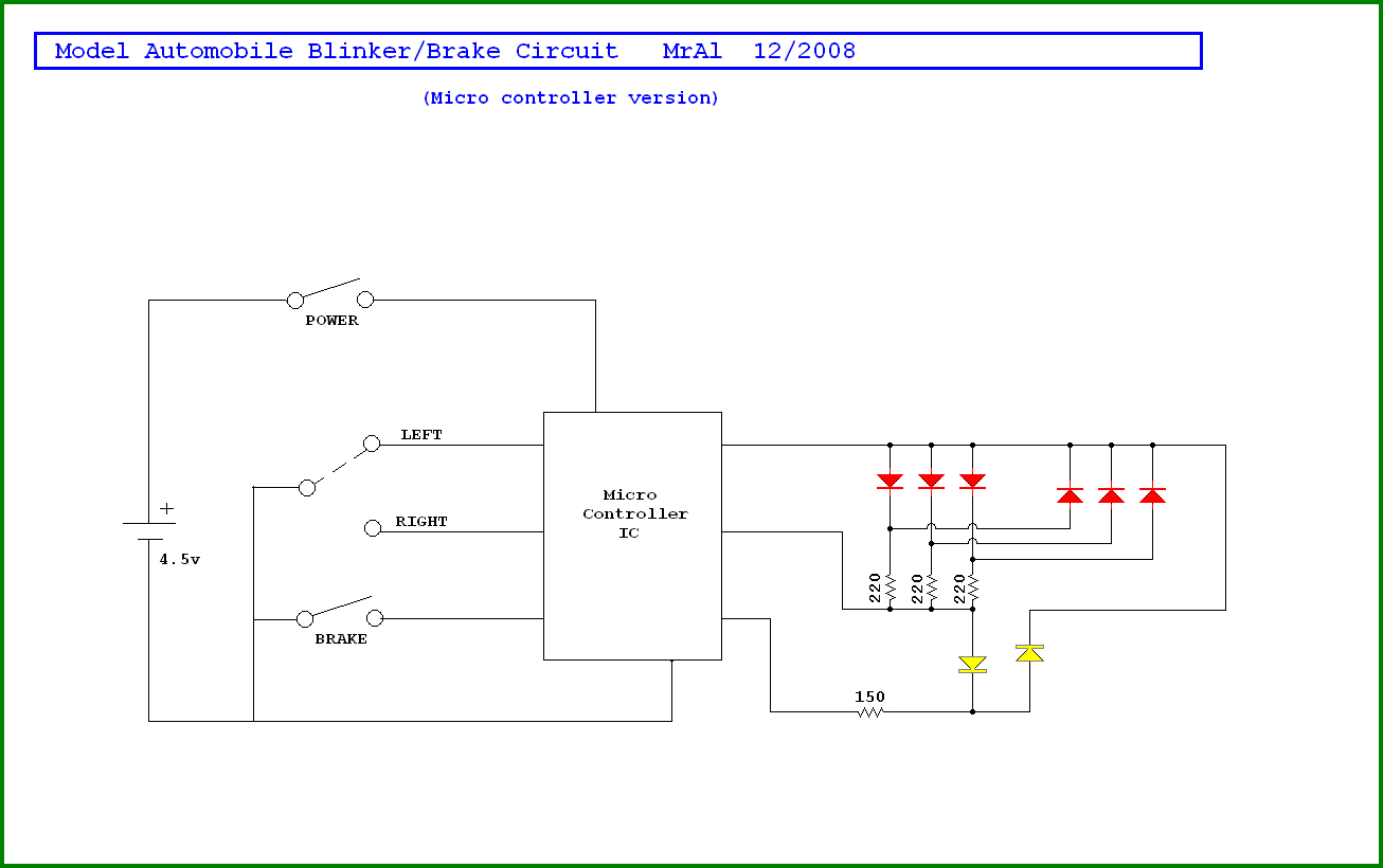

Here is a new drawing showing the yellow LED also.
(see previous post for yellow LED connections)

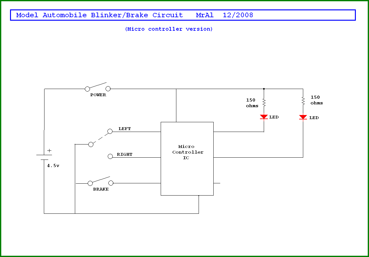

The micro controller version is so simple i drew up a quick drawing.
Note the use of a 4.5v supply instead of 6v, and the overall simplicity.
It makes wiring it up a lot easier.

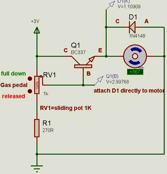

Hi oldman23,
the schematic and layout provided can not be used with 1.5V since the timer IC NA555 requires a minimum supply voltage of 5V.

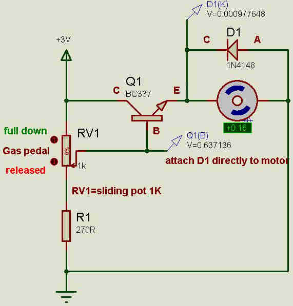

Here is a super simple control circuit for your "car engine". Connect a sliding pot (or rotary via linkage) to the gas pedal. The pot should have a value of 1K. Connect a fixed value 270Ω resistor to the lower end of the pot, and connect the resistor to ground. The upper end of the pot is connected to 3V.
(You must have at least 3V to have a reasonable output voltage with the circuit. The transistor's forward voltage drop is approx. 0.7V which will be missing when operating the motor.)
Connect the transistor as shown in the screenshot. (EBC are marked). Attach an 1N4148 directly to the motor with cathode at the transisor emitter to prevent back EMF which will destroy the transistor.
You won't need a PCB for a circuit like that. Just connect parts using fairly strong wires.
The upper end of the pot must physically be down for full throttle. The fixed value transistor takes care of almost no current flow when the gas pedal is released and also for quick reaction as soon as it is off the "idle" position. (voltage across the motor 900µV.)
The maximum output voltage at full throttle could go as high as 2.3V, but the motor is designed for short time operation anyway, and it shouldn't matter at all.
Boncuk

Hi again,
In addition to my previous two posts which showed two
schematics, here is a newer drawing of the microcontroller
version showing the connections for the LEDs better.
Note that with this circuit it is possible to operate the RED
brake lights while the YELLOW front parking/blinker lights
do not come on. Thus, the yellow lights only come on for
the blinker and not the brake.

Hi again,

The microcontroller circuit ic chip DIP package is about 1/8 inches
high. That's the height only, and the length is about 0.5 inches
long and the width just a hair over 0.3 inches wide.
See i can make one of these if you think it could fit, but it would
be harder for me to do the SMD package because for one i dont
have any stock ic chips so i would have to order them and also
i would have to set up a jig with a socket to hold the SMD package
because my programmer uses a DIP socket. It's possible but it
would take me some time to set up. On the other hand, i could
probably have a DIP package made in a couple days.
The dip package leads could be soldered to directly or else
bent out at right angles and soldered down like an SMD part
only the leads are spaced 0.1 inches apart instead of 0.05 inches.
I would have jumped with this idea sooner but you had told me that
your height restriction was 0.087 inches, and this would be about
0.1 to 0.125 inches high. Is there any chance at all that you could
squeeze another 0.02 to 0.04 inches for the height?
Another idea i guess is to prototype using a DIP package, and if
that works out switch to SMD at a later date.
Your thoughts on this?
