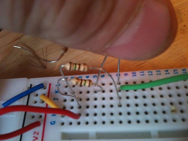

I placed one resistor in series with the LED and I tested the draw it was 20mA, this wasn't enough to keep the battery on and it went off as predicted in 30 secs. I placed the 2nd resistor across the + and - of the power supply. This meant that I now had a current draw from the battery of 60mA, the resistors I used were both 150ohm brown,green,brown. I left the unit on for several minutes and there was no noticeable heat and the LED was not to bright.

My last question is, Have I made a mistake,,,,is it ok to put the second resistor across the battery terminals like this or have I misunderstood you and I should have also put this in series with the other resistor.
I have attached a photo to show what I have done, the led is lit but I put my thumb over it as the red glow made the resistor colours look different.

Don't buy cheap Chinese LEDs that don't have a detailed datasheet.
LEDs burn out because you have exceeded their maximum allowed current that is shown by the manufacturer in the datasheet.
You have a 2.0V red LED in series with a 150 ohm current-limiting resistor and powered by 5VDC. Then the current is 20.0mA.
You have another 150 ohm resistor across the 5.0V so its current is 33.3mA. A 1/4W resistor will get warm.
The total current is 53.3mA.
If you need more current then add more LEDs with resistors or more 150 ohm resistors across the 5V.
