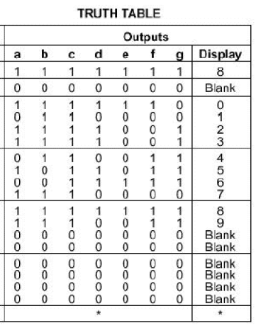

Below is the truth table for a 7-segment display. You generate code so you end of with the shown sequence for the desired number in the shift register.
For example for number 4, the code in the shift register would be:
Q7=1 (G) (1st serial bit output)
Q6=1 (F)
Q5=0 (E)
Q4=0 (D)
Q3=1 (C)
Q2=1 (B)
Q1=0 (A) (last serial bit output)
Do the same for all the other numbers. I don't understand your code well enough to tell you how to write it.

The shift register has 8-bits and you are not using the Q0, so you output eight serial bits from the pic to the shift-register with the first seven being the segment bits (G-segment first), and the last bit is a don't care (either 1 or 0). After the 8-bit shift you stop the shift-register and the display will then read the segment output values (and if you did it right, the desired numeral).

I'm not much of a code writer so someone else will have to help you with that. But conceptually you can use a lookup table to convert the input number to the required sequence for the display. This lookup table can be stored in EPROM. For example the display sequence for number five could be stored as an 8-bit word at address 5 in the EPROM. Thus when number 5 is input, you go to EPROM address 5, which will have the sequence to display 5, which you then send out serially to the display shift register.
Since your driving a single 7 segment, you can cheat with a lookup table. Consult the instructions for whatever language you're programming in, nearly all of them have a lookup table function. Assign values provided by Carl's truth table to the lookup table's index positions 0 through 9. Then it's a matter of choosing the number you want, grabbing the appropriate binary code from the index position from the table and shifting it out to the '595.
In Proton Basic:
' index positons equal decimal value you want to display
' I'm going with LSB = 0, but it doesn't matter
' I didn't put all the values in, just 0, 1, 2 and 3
Segments = LookUp IDX, [252, 96, 242, 182]
