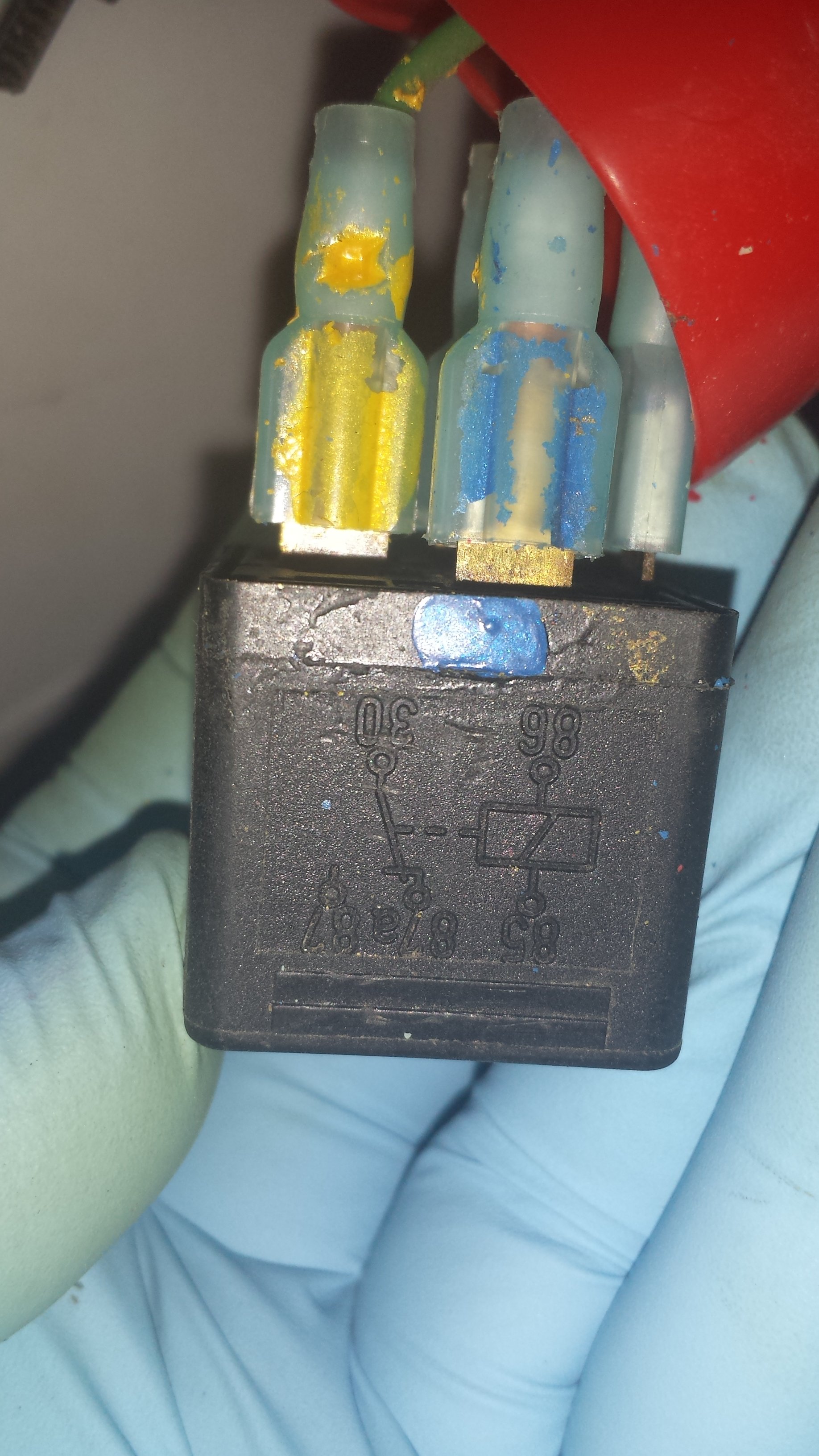

Attached is a photo of something under the hood of my car.
Could someone please tell me based on the diagram what the little square block with four leads does?
It is a relay, an automotive version according to the standard numbering of the coil/contacts. (85 & 86 are the coil)
SPDT, (single pole double throw).
Max.
What is a relay?
Probably you know but maybe not.
From 87 to 30 there is a switch. It turns some thing on/off.
Between 85 and 86 there is a electronic magnet. (wire around a post) When 12 volts is applied it makes a magnet that pulls the switch closed.

You got it, but there is more.
A relay can be thought of as having current gain; the coil current (a few hundred mA or less) of a 12V automotive sugar-cube relay can switch a 12V load that draws up to 30A. An electronic output from an ECU can switch the headlights, horn, or blower motor...
It can be thought of as having voltage gain; a 5V relay coil can switch an AC-line powered (120Vac to 250Vac) load. A microprocessor can switch a several HP motor (up ~ hundred A)...
It can be thought of as providing isolation between the coil side and the load side due to the large air gap between the coil and the armature (contacts). This is used to electrically isolate the control side from the load side for safety, or to avoid coupling electrical noise intrinsic on the AC line back into a microprocessor....
There are also applications where relays are used as circuit elements. For example, it common to use a relay as a "latch" (flip-flop), meaning it can "remember" that a momentary pulse "set" it, and that power was interrupted to "reset" it...

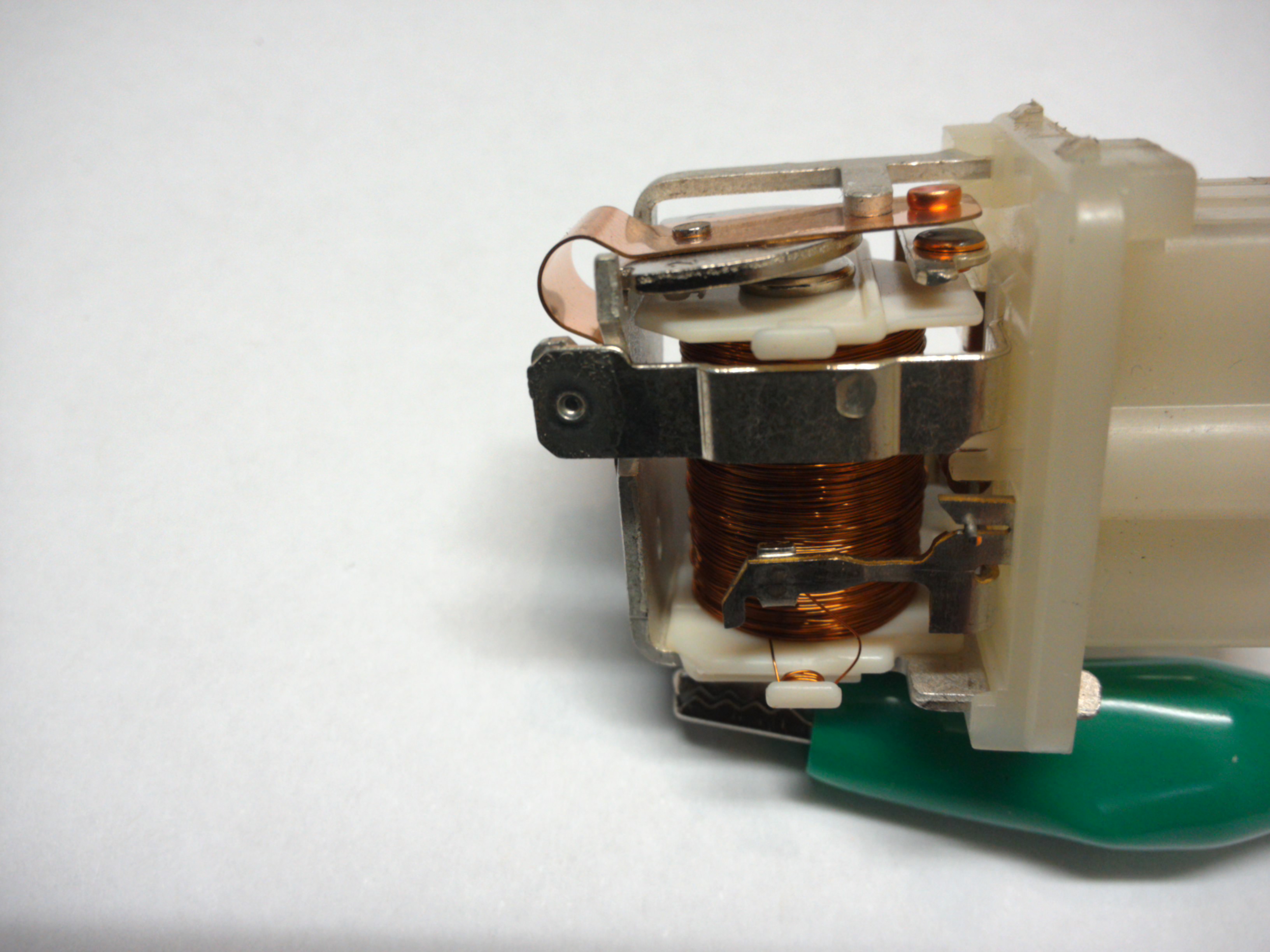

Photo of the inside of a automotive relay.
The coil is energized with 12 Volts which can control a bigger load which is switched by the relay contacts.
