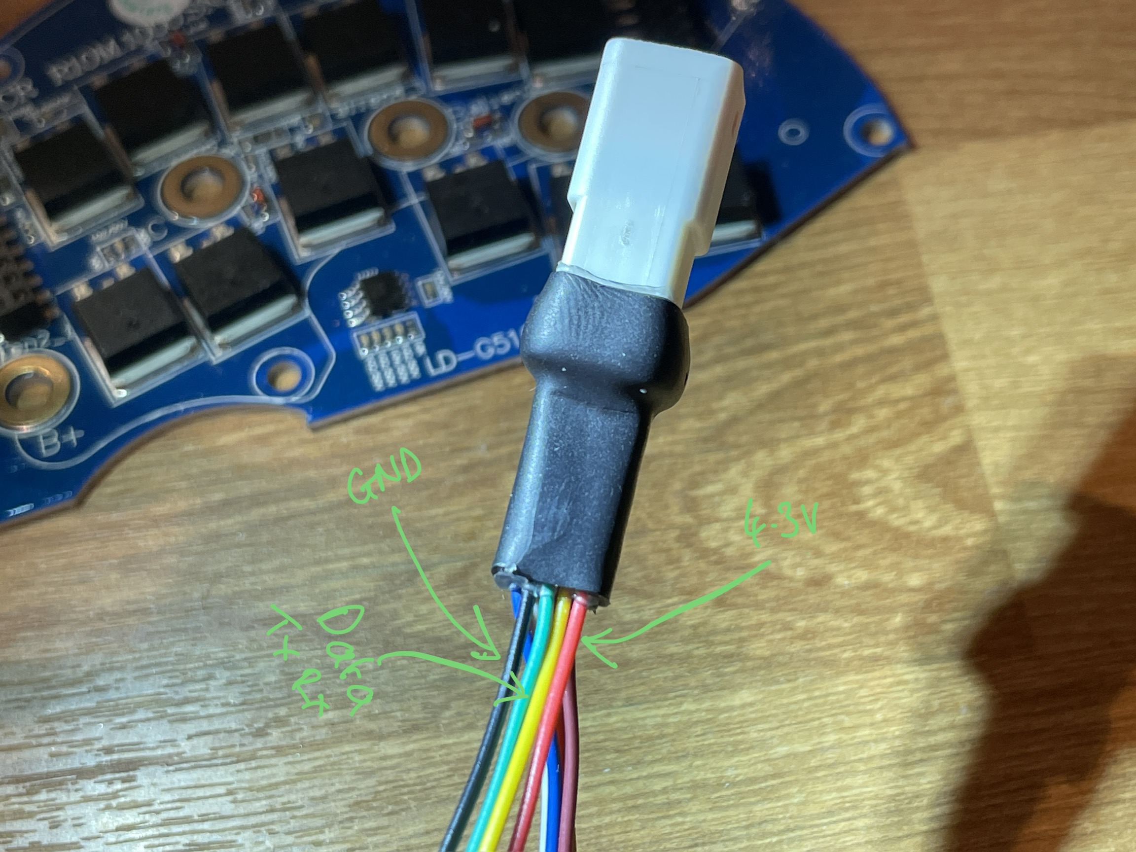

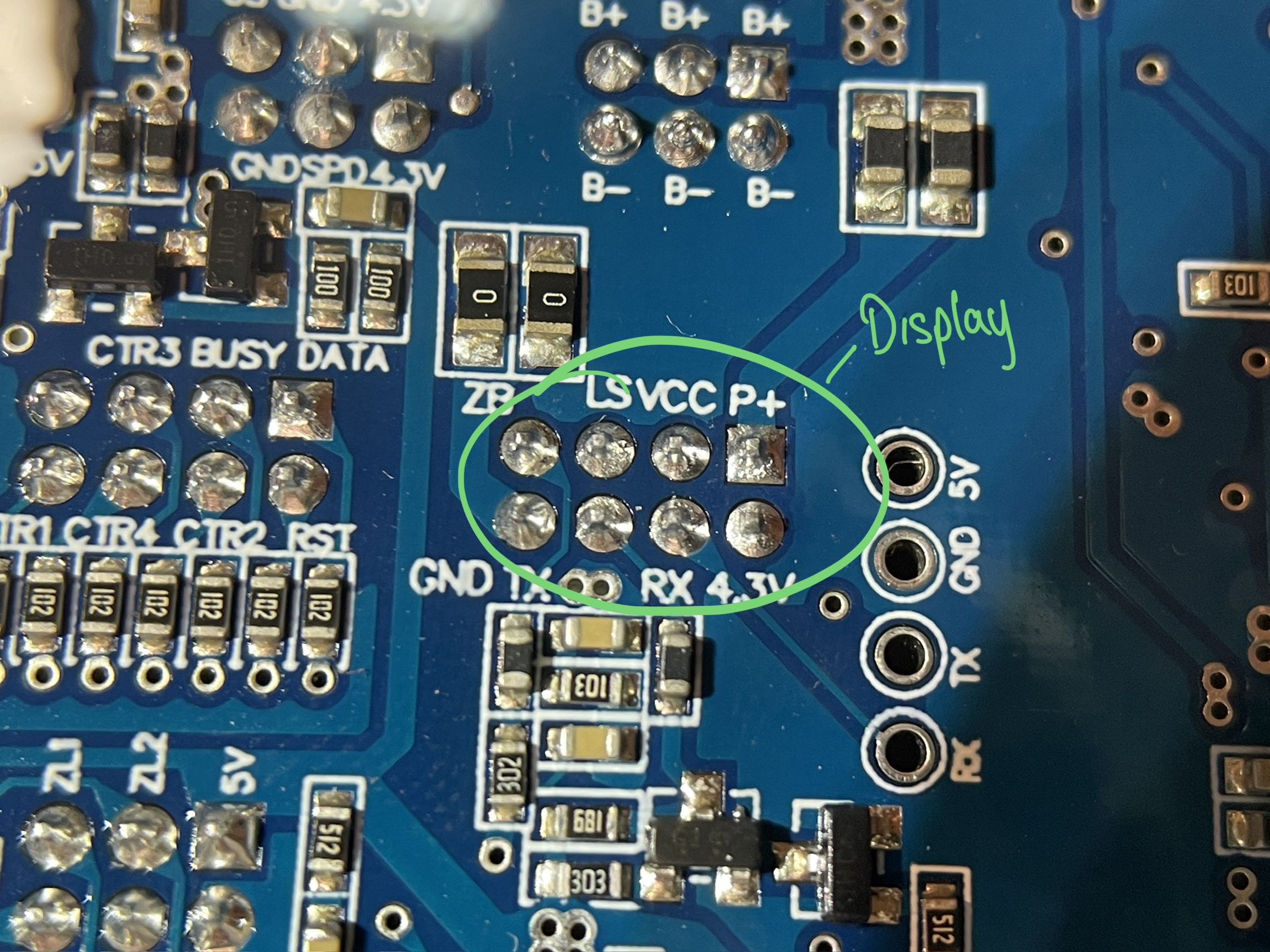

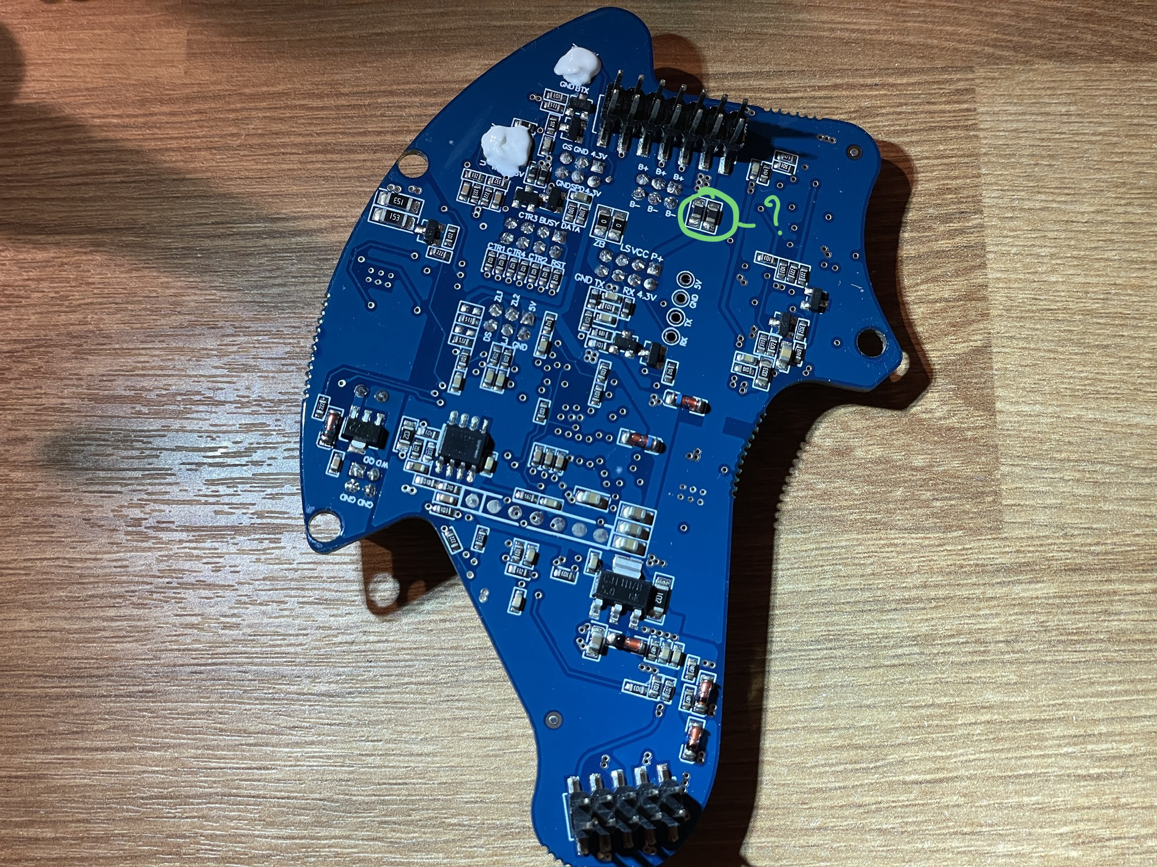

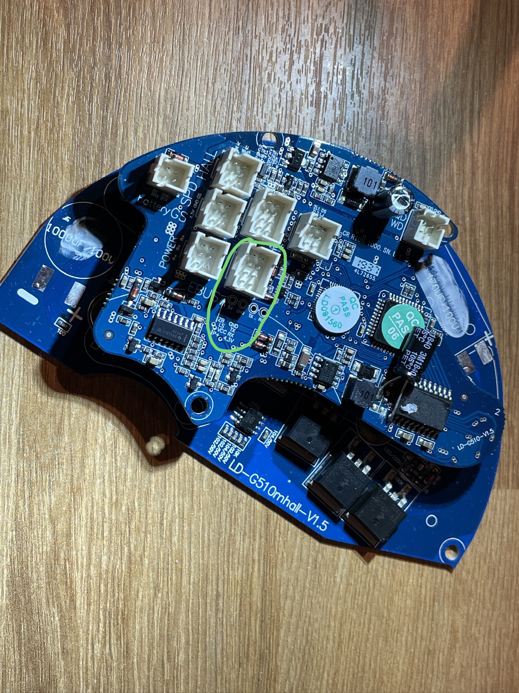

Thank you for the detailed yet understandable explanation! Here are the displays specifications https://manual.eggrider.com/display/specifications/#current-consumption , they say that the max is 20mA. I am assuming that that includes when the motor controller is being reprogrammed and bluetooth active.
This diode was the last missing piece to the puzzle as I am trying to convert the whole motor system over to 72V from 48V. I have 100V capacitors and 100V FETs for the power side and now I will get the TVS diode to install in series with the display. When everything is finished I am hoping to achieve 4.5kW peak output whilst keeping everything more or less stock. I recently found an absolutely beautiful adjustable Huawei R4875G1 rectifier that has been modified with a bluetooth CAN interface and tweaked guts that will allow me to charge the battery at up to 4kW. This thing is dense at 29x12x4cm! It will be paired with a type 2 EV connector for the ultimate ebike charging.

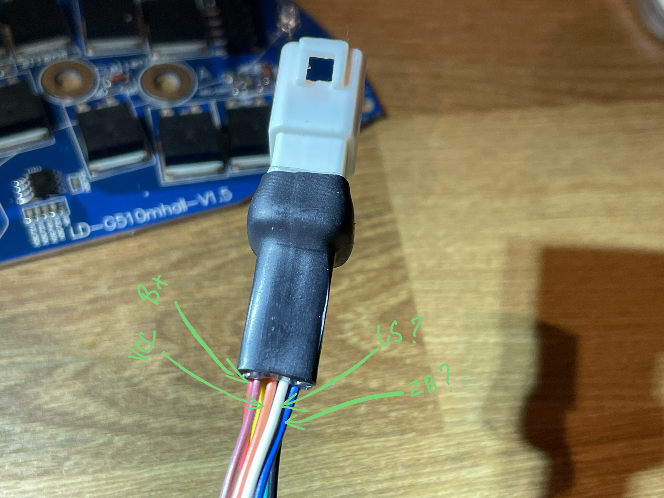

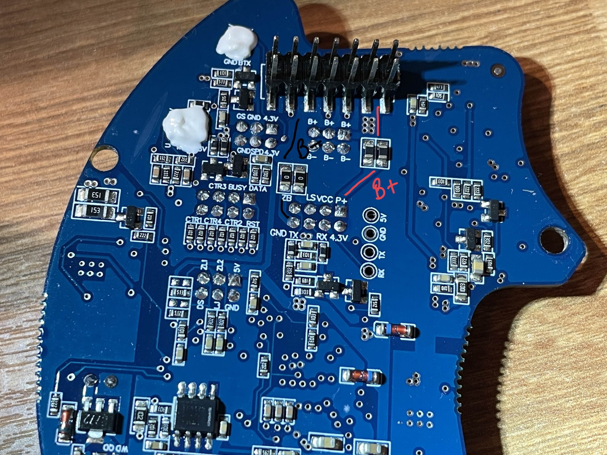

I don't know how to do that? The voltage from the battery is 84V-55V and the voltage on the display is 60V-38V, what do I need to do to do it the way you described?
An NPN transistor with the collector connected to the battery +ve.
Connect the controller +ve to the emitter. Connect the battery -ve and the controller -ve together.
Connect a 22 kOhm resistor between the base of the transistor and -ve
Connect a 10 kOhm resistor between battery +ve and the base of the transistor.
I suggest you draw out that circuit.
The two resistors will divide the voltage to give 22/32 or 68.75% of the battery voltage. The transistor will allow more current to flow to the controller than you could get from the resistors, while supplying about the same voltage as the resistors give, less about 0.6 V.
The transistor needs a voltage rating of 100 V or more and a power rating of 1 W or more. If you use a TO220 package transistor, the tab is connected to the collector so will be at battery voltage and needs to be insulated from -ve.
Check that you are getting around 2/3rds of the battery voltage before connecting the controller.
