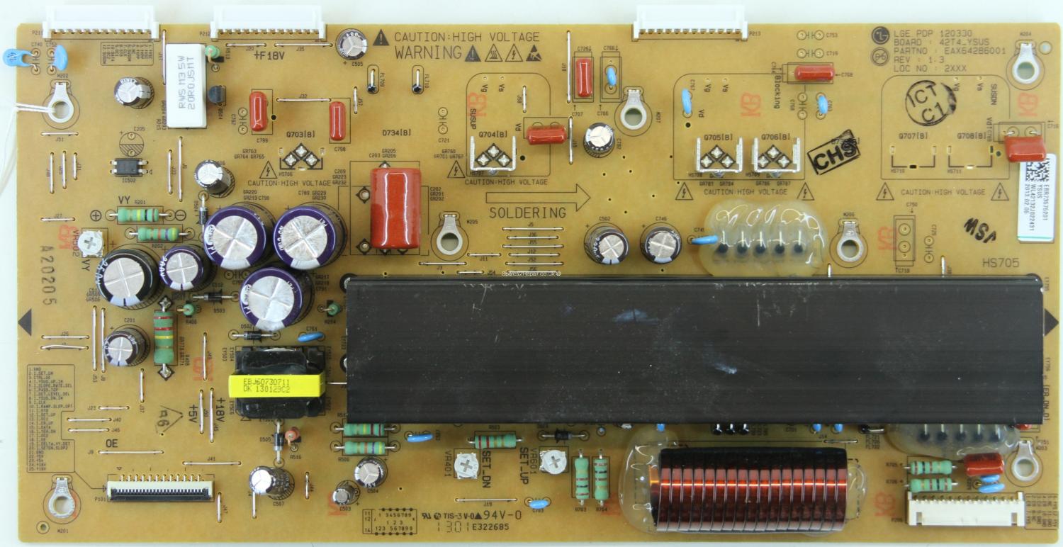

The Y Sustain board on the LG I have here is faulty. The IGBT (2 shorted) are Trench gate IGBT. Originals not available.
Anyway, I would like to know from a Wizard here what are the important parameters when choosing alternative IGBT for a Y Sustain board.
From the original parts on the board, I have the RJP 30h in stock. The problem is the other blown one. IRG 7SC28U. It is discontinued long ago. So can anyone tell me the important parameters to search for when looking for a replacement?

lg-lg-42pn450b-ysus-eax64286001-rev13-ebr73575201-pdp-120330-42t4_ysusjpg.image.1500x772.jpg

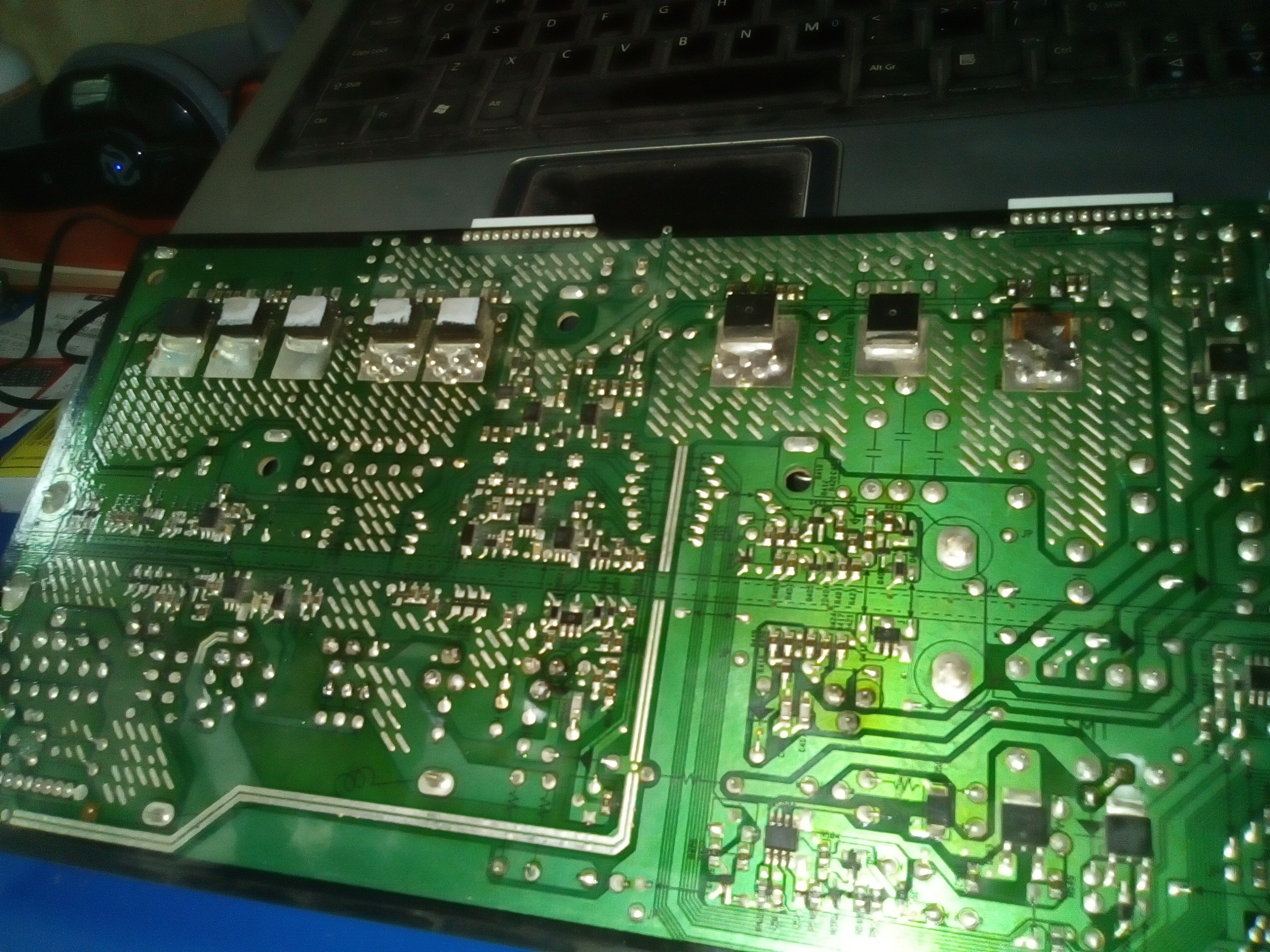

The IGBT are under the board. The small heatsink fins you see are supposed to help dissipate heat from the IGBT below.
I've the board here I'm busy working on if anyone needs a pic. Camera not so good tho.

Q709 in the kit I can't find on the board Nigel.
The rest I believe I can source locally (alternatives with similar or better specs from RS here and in stock).
Q709 worries me.
And I can't find a diagram of the board.
Q709 worries me.
According to a thread on a forum, Q709 is mounted on the heatsink.
It's also labelled here:

We have decided to order the kit. Q709 is indeed faulty too. Gonna change all 5 transistors. Thanks for all the help Nigel :) :)
Aaand the parts arrived at last today. Fitted and yea babyyy :)
Everything working perfectly :) :)
