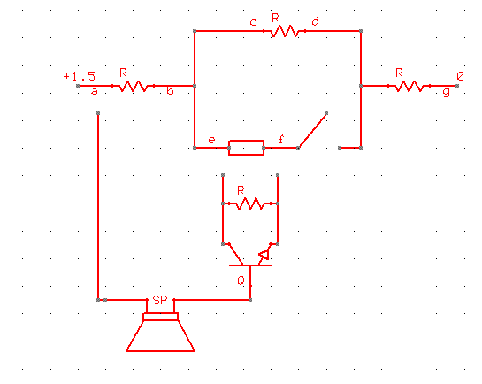

Let's supose I have this deadly simplified, DC (no pulse signal) circuit (above). Rectangle is the LCD segment. Small letters are the points where I could connect a lead. Values of resistors no supplied.
Let's also supose:
a) V e-f <0.6V
b) V e-f >=0.6V
The below circuit is an idea for case b) (more resistors might be added). But, in case the switch is off, excess of current could flow through the other branch? Could it dry the battery? I'd like to know how can I design these kinds of circuits with minimum repercussion over original currents (again)!
In case a), I think I can put a second battery.
Ideas?

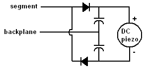

Your problem is that you are trying to drive a piezo element that resonates somewhere between 3-6Khz with a apx 100Hz waveform from the LCD driver circuit. What you need is a piezo with a build in driver that runs on 2-3Vdc and then rectify the 100Hz AC into DC. Something like this may work (You'd have to use germanium or schottky diodes) but it's hard to tell how much current the LCD driver can source:
