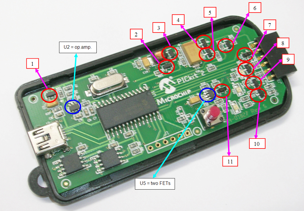

If nothing, if somebody have (or is willing to do :D) close picture of newer/newest original PK2 (these with "red button" instead of older ones with "black button") of PCB I would be very grateful!

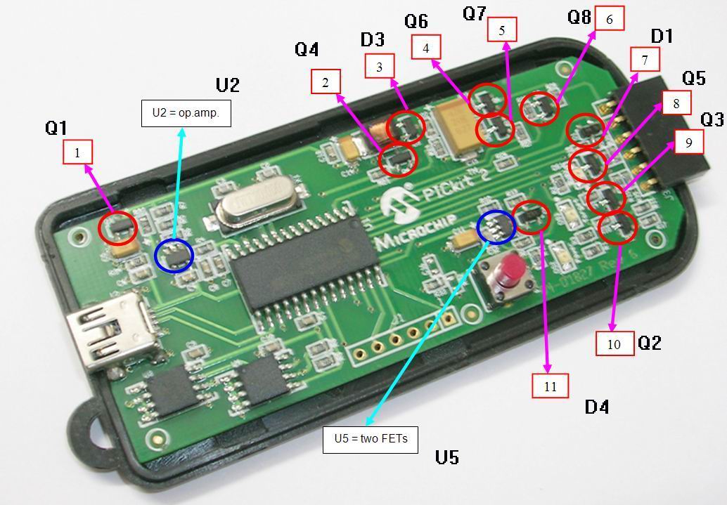

Also, I have noticed, on blurry pic of newer orig. PK2, there is 12 transistors, while in my old schematic there are only 10 - if anyone knows what is purpose of that two "extra" transistors - please tell me!

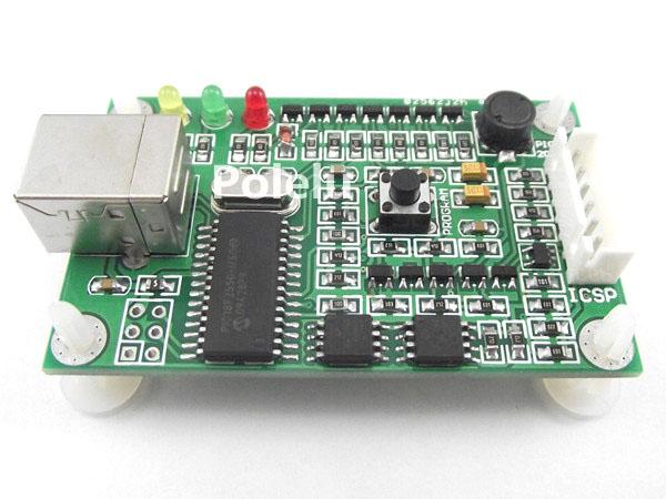

Yes, you're right, I see that resistors now. But there are some other changes too: please see PDF in attachment! On the other two attachments: if you carefully look, you can count more than 10 transistors, it seems to me that I see even some additional IC? Second JPG shows some PK2 clone - you can easily count 12 transistors (+op.amp.IC).

Think you are beating yourself up over nothing - as said earlier I think you will find the Sure unit will do the same as the current Microchip unit.
That update file is very old and clearly the Sure unit has those important output resistors.
I got my MC PK2 in 2007 and just opened it up - thats a Rev 5 board like your pic.
Re the transistor count - Microchip use a dual transistor package for Q1 and Q2, and the clones sometimes slightly change other bits of circuity around the op amp but achieve the same results.
Yes, that must be U5 chip (6-pin) next to the button. I take them into account as 2 transistors. But, if I counted (and seen) well there is 10 transistors more = 12 transistors in total. So, IMO there is two additional transistors - in Microchip's schematic there are 8 trans. + 2 FETs (6-pin chip). It is really not so important to me, I'm just (very) curious. I see that other clone with obviously 12 transistors onboard - I contacted the seller of that clone for schematic and I'm awaiting reply. I just wonder if Microchip maybe changed something since 2007...
I think I know what's the stunt! These two "extra" transistors are not transistors, but TVS (Transient Voltage Suppression) chips! Sure's PK2 uses two 4-pin dual TVSs, Microchip, if I think right, uses them also but in 3-pin package (so I wrong identified them as transistors! What is true is that Microchip didn't update PK2 schematic since 2008; I think, as Logic Analyser Tool was added to PK later - there was a need to add some protection to I/O pins of PK - so there they are (but not on the MC schematic)!
@WP100: if you are still here, and your PK is still open :D you can check (if you want of course): two pins of each TVS must be connected to D+ and D- terminals of USB connector; ICSPCLK and ICSPDAT on ICSP terminal, and third pin from both are connected to GND.
As far as I can see there is no TVS chip or similar components on the Microchip unit.
Have just checked both diagrams and they each contain 10 transistors ( allowing for 2 in U5).
Checked my actual MC PK2 and again just the 10 transistors , its the updated board with the 4k7 output resistors on the component side of the board, like that first jpeg of yours and not like that rework jpeg.
Have not heard of any MC hardware update for the Logic Analyser tool ? - I have used the LA and mine works fine.

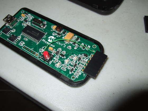

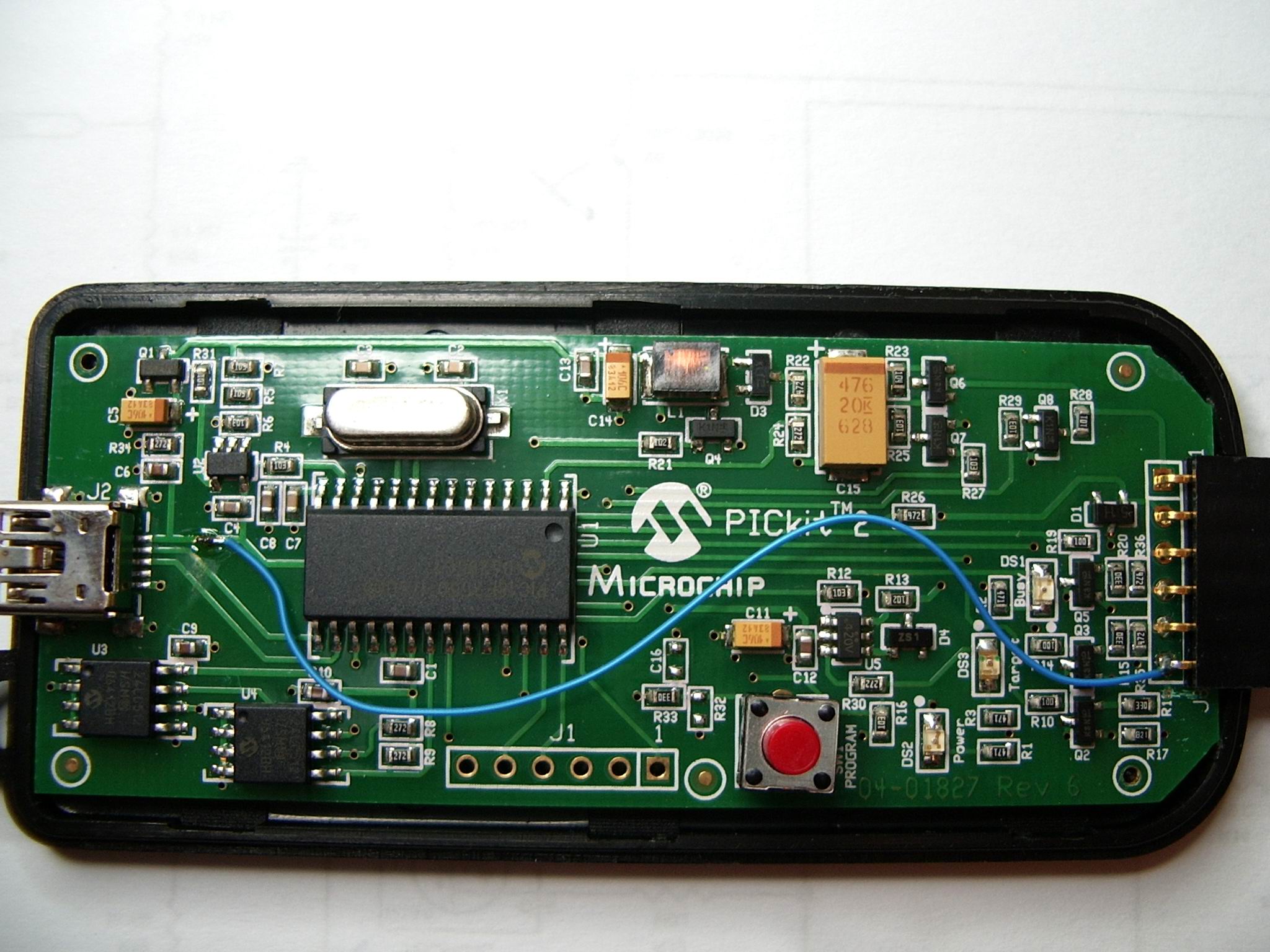

Anyway, if you are willing, please check again pics in attachment! Can you PLEASE tell me what are markings on PCB for that red circled components (3-pin transistor-like) - I mean Q1, U1 or so? On the smaller, very blurred picture you can see the same components from the other angle.
TIA, and sorry to annoy you!

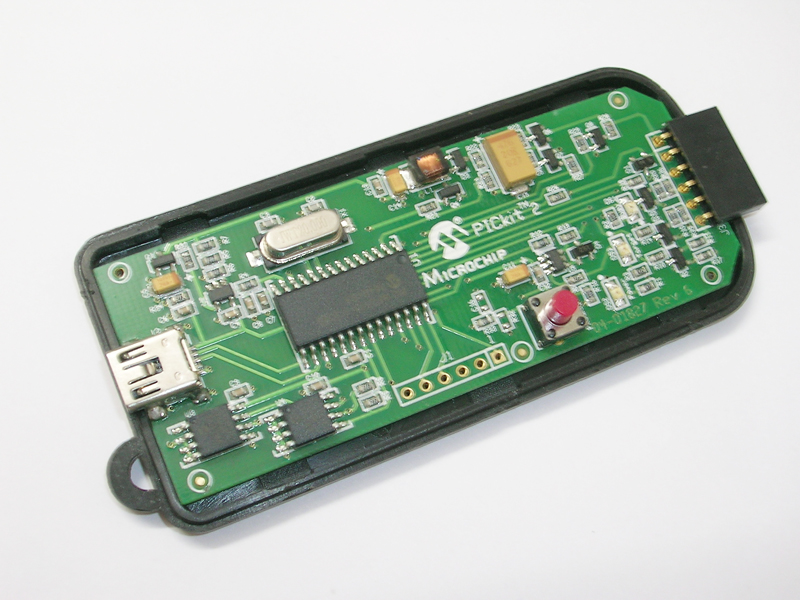

Was taking some other photos so thought I would see how a close up of the pk2 would come out.
Think you can see all the parts and the silk screen ok
The blue wire is my mod, the Pk2 can only supply about 25ma to the target circuit, I have sacrificed pin 6 ( only used by LA ch3) and connected it to the +5v on the USB socket so I have 500ma USB power available to my dev board.
Yes, I can see all clearly! There is no many pictures of PK2 (especially not of genuine PK) with so many details - actually, it is the only I found by now! And what to say than THANK YOU again! When I receive my PK2 I will do the same, so the others see what is inside + (maybe) a little review!
