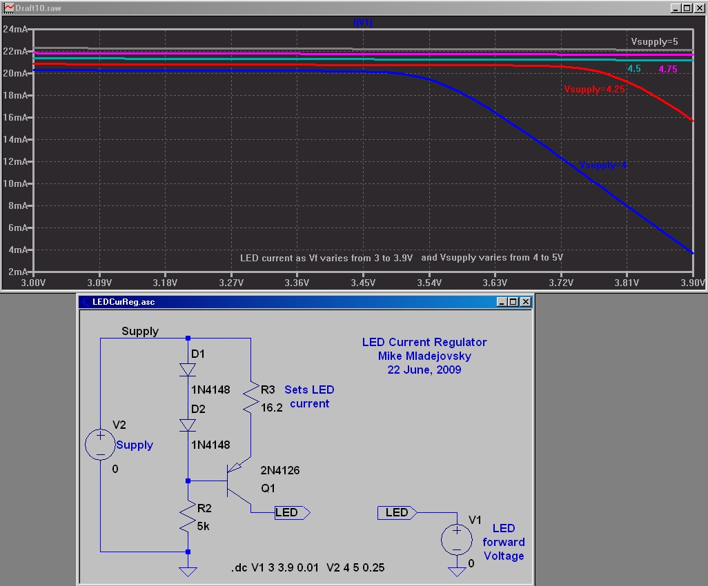

If the current variation due to LED differences is too large using a resistor to limit the current, you could use a constant current source consisting of a transistor or op amp and associated circuitry (Google "constant current source" for circuit examples).

I think the OP's confusion stems from the fact that the variation in Vf becomes less important as the supply voltage is increased. e.g., if the supply voltage is 12V, then a variation of Vf from 3V to 3.7V causes an insignificant variation in the LED current because the drop across the series resistor goes from 8.3V to 9V; an 8% variation.
OTOH, if the supply voltage is only 4V, then the drop across the series resistor would go from 0.3V to 1V, a 333% variation. This is where an active current limiter (transistor or IC) would make sense.

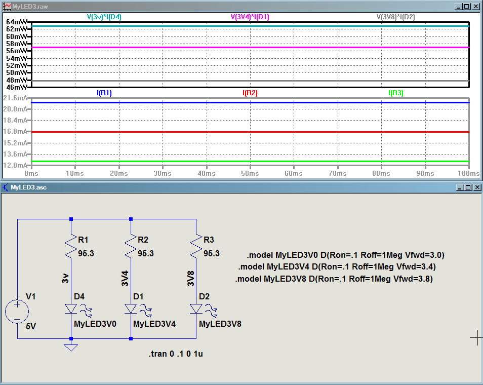

If an LED is 3.0V at 20mA then at 3.4V it might try to draw 67mA which will burn it.
You must limit the current. The LED takes care of the voltage.
With a fixed 5V supply and a max of 20mA/LED and a spread in Vfwd of 3.0V thru 3.8V, using a same value resistor for all LED's of 95.3R.
The graph shows the range of currents and power dissipation for each LED.
It would help if you posted the LED type so that we could check the d/s.

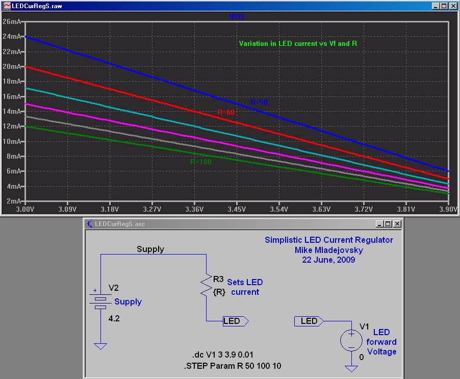

In the case of loose Vf tolerance, one more spec should be considered, that is luminosity as a function of current. For example, I found a spec for a device which gives these values for relative luminous flux v. forward current:

So, for example, assuming nominal forward voltage drop of 2.5V, and max and min of 3.0V and 2.0V respectively, and assuming 5V supplies, we can easily determint the relative luminosities:
case 1: Vf=2.5V (nominal)
For I=250ma, R=2.5V/.250 = 10 ohms.
relative radiation = .65
Case 2: Vf=2.0V (minimum)
I=3V/10ohms=300ma
relative radiation = .9
case 3: Vf=3.0V (maximum)
I=2V/10ohms=200ma
So, by designing for 'nominal' value of Vf, then using a device at the 'high' limit of Vf gives about 8% less radiation. That might or might not be acceptable. Also, for Vf at the 'low' limit gives a current that might or might not burn the LED.
If any of these limits are unacceptable, then you must either use a different LED, a different voltage or use a current driver.
  • LEDCurReg.asc
