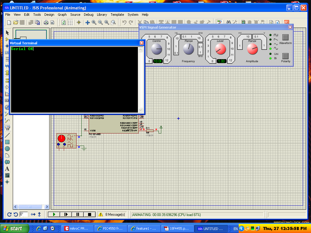

I am trying to build a humidity sonsor using HS1101 and 555 timer. The humidity is calculated based on the freuency. And I found several coding example and combiled them to find the frequency first using Mikroc pro. But when I run that in the Proteus nothing displays on the virtual terminal. But the serial communication is working. The entire codings are posted below.
Can any one Please help me! It's an urgent matter!
