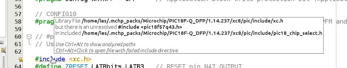

Just sharing a bug I found in the MC XC8 2.32. also 2.40 .
Symptoms .. PIC18F57Q43 code complied but with many errors and warnings . check the #include <xc.h> line. [ The PORTE didn't work ]
Fix.. the plib file was missing from the XC8 directory, I took a guess and copied and renamed the lib file into the 2.40 include directory as plib . Code compiles now without the ‘red weed ‘of errors. ( fix is right picture ) .
( I'm running linux.mint 20 . MPLABX 6.0)
Tell MC that ... there is something amiss xc.h is looking for plib. As i posted lots of warnings and errors an PIC not working, although it complied, till I changed the file ...

From my investigations #include <xc.h> eventually references plib (dir) , as it has the pic18f57q43 .inc and .h files. and a hundred others !
Just to repeat the code compiled even with all the red errors,and didnt go away ( porte didnt work ) untill i moved and renamed the lib to( could have been proc i hacked not lib ) ( I copied the directory as it had the inc and h files ) xc was complaining about .

This was a new project with the Q series, so i was checking the config and mainly the clocking possibilities, so the code only had #include <xc.h> and was just a few lines getting the reference clock to output on PORTE ( Should have but failed ).. Originally there was no plib directory under the v2.40/pic/include/ directory. the v2.40/pic/lib directory has or HAD 100s of PIC device .h and .inc files , and as xc.h was eventually looking for v2.40/pic/include/plib directory , I gave it one ...so yes my code did need a pic18f57q43.inc (.h) within a plib directory. Should say i have since found out I'm not the only person who hit this bug..
further .. far as i can tell plib should not be part of the xc2.40 file structure . but my project would not 'function' until i added it !
still investigating .....
edit, I removed the plib i created all the red errors and warnings came back ...
Conclusion .. project builds no errors with my plib directory. think i am chasing stuff way beyond my skills.

On my installation, there are no .h or .inc device files under v2.40/pic/lib.
All the device files are located under the pic/include/proc folder
... and don't confuse the red-squigglies in the brain-dead MPLABX IDE with actual problems.
The only sure-fire way to know if you have a problem is to compile it and see if the compiler barfs.
If it compiles you're good to go.
This is purely an IDE issue that mchip don't seem to be able to fix. Better men have tried and failed. You'll be changing your moniker to 'great granddad' before this is (possibly) ever resolved.
