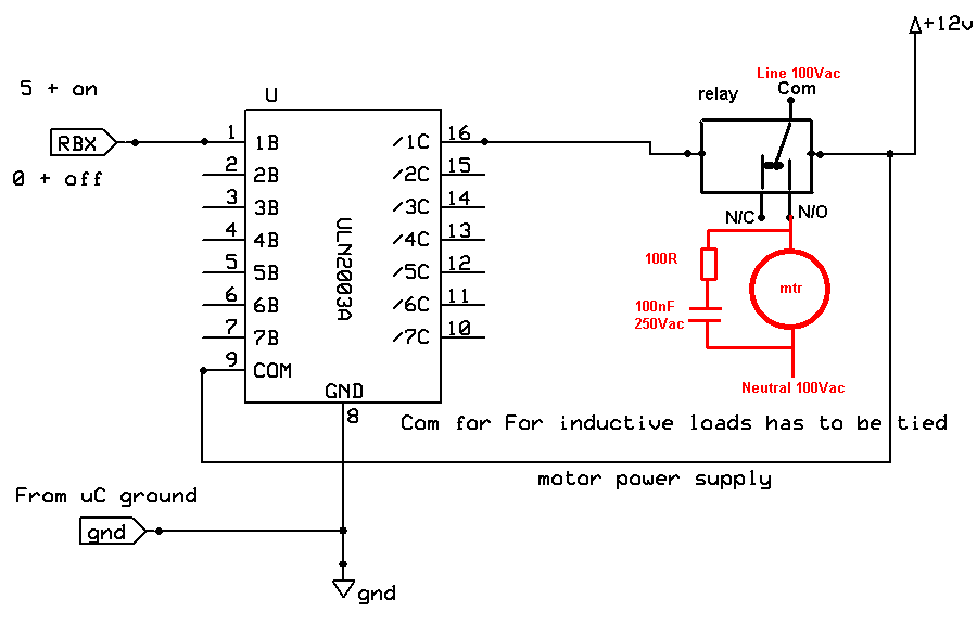

Dear Sir,
Anyone can help me to connect the PIC to Relay thro' ULN2003A (to run alarm when Interrupted Occurred). I have used PIC18F452 in my project. Now Everything works fine. I have connected 6V Buzzer to PIC thro' ULN2003A. It works. But, I like to connect alarm which runs at 230V. I have 12V Relay on my hand. It has 5 pins. I know only little about Relay and it pins. I know how relay works. But I don't know how to connect the relay from ULN2003A. If anyone provide help with pin diagram, it will be very helpful. Thanks in advance.

Here a little something to go by

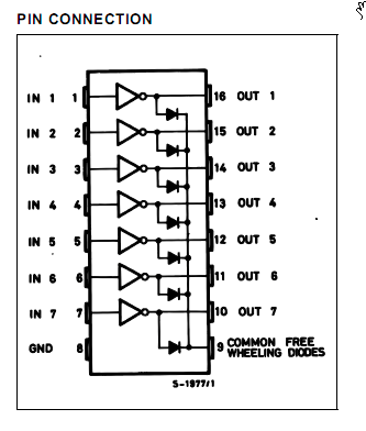

On his diagram 'Burt' has already shown the COM connection to +Vs, the ULN has in built suppression diodes, all linked to COM.

One more thing Mr. ericgibbs. I have connected everything as shown in the circuit. If I connect COM of Relay to 110V AC to run a motor what should I do? Will the ULN take all the responsibility to take care of Back-emf?
The ULN diode will suppress the back emf from the relay COIL.
Add the R and C across the motor, its a snubber that helps to reduce relay contact damage and electrical 'noise'

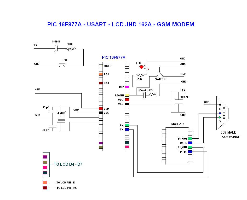

I don't have 100K and 100nF cap on my hand now. I have to buy tomorrow and use it on the circuit and let you know. Now PIC 18F452 runs at +5V input (along with MAX232N to communicate thro' RS232 to GSM Modem). I like to run the PIC using Cell Phone Battery rated +3.6v, 1500mAh (available around +3.45V to +3.5). Just I replaced the existing current source with battery it won't works. Anything I have to add/modify in my circuit. Please help me.
The circuit is the 100% same except PIC16F877A (Here I have used 18F452).

hi
Its a 100 R not 100K.
The MAX232 operates from 4.5V thru 5.5v Max, so 3.6V is not acceptable.
EDIT:
There are no caps shown on the MAX232, is this just a drawing error.???
Look at the MAX3232 for 3.5V operation.

for simplicity, I didn't mention the caps that are connected to MAX232N. Currently I am using GSM Modem. So I have to use MAX232N. But in near future I am going to communicate GSM Module which runs at 3.6v and can accept TTL signal from PIC. I guess it is OK to use 3.6v, 1500mAh cell Phone Battery. Am I correct?
Did you read what I said about the MAX232 operating voltage.???
and the alternative MAX3232 that will work at 3.5v.
yes. I read. It requires min 4.5 to 5.5v max. So, it can't be used if we are using 3.6v battery. Now you told MAX3232 will work at 3.5 volt. I have to try now. I like to avoid MAX IC to preserve battery current. Actually, I need to communicate the GSM Module from PIC18F452. So, we can use 3.6v battery to operate entire thing. No need for MAX IC. Am I right?
