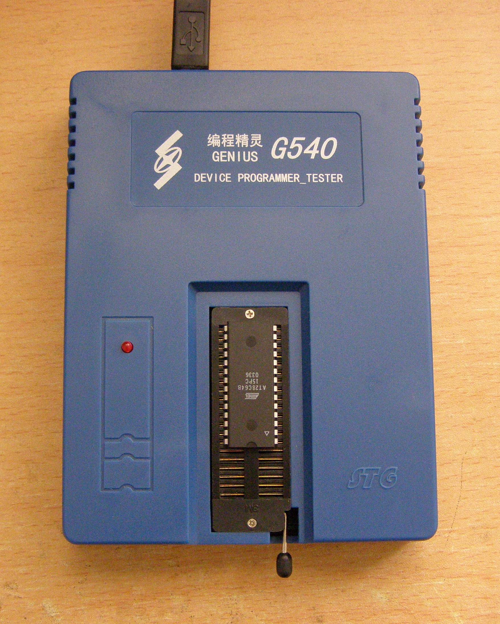

I've just started to work with PIC16F887 and I have some problems. For programming I use (Genius) G540 programmer with the following configuration: FOSC0=0 ; FOSC1=1 ; FOSC2=0 ; WDTEN=1 ; PWRTE=0 ; MCLRE=0 ; CP=0 ; CP0=0 ; BODEN0=1 ; BODEN1=1 ; IESO=1 ; PCMEN=1 ; LVP=1 ; DEBUG=0 ; BOR4V=1 ; WRT0=0 ; WRT1=0.
The problem is that when I program the microcontroler the circuit will not respond properly; let's say I write the following sequence:

After programming the output of PORTB is something like: 00101111 and could change after another programming with the same program. Also I have to mention that the first time when I program the PIC all the FOSC0.....MCLRE....WRT1 pins where 1.
What do you think is the problem??
Your prob may be LVP being on causing the MCU to slip into prg mode. I think u have to hold RB3 low to prevent that. Anyway try this config, and forget the external oscillator crystal & caps:
__CONFIG _CONFIG1, _PWRTE_ON & _WDT_OFF & _INTOSC & _BOR_ON & _LVP_OFF & _CP_OFF & _MCLRE_ON & _IESO_OFF & _FCMEN_OFF

Like I said on the first post I use for programming Genuis G540 ("a piece of sh..t") and what I've noticed is that I give the program one configuration let's say:FOSC0=0 ; FOSC1=1 ; FOSC2=0 ; WDTEN=1 ; PWRTE=0 ; MCLRE=0 ; CP=0 ; CP0=0 ; BODEN0=1 ; BODEN1=1 ; IESO=1 ; PCMEN=1 ; LVP=0 ; DEBUG=0 ; BOR4V=1 ; WRT0=0 ; WRT1=0 and after programming when I read the microcontroller it gives me all 1 (FOSC0=1 ; FOSC1=1 ; FOSC2=1 ; WDTEN=1 ; PWRTE=1 ; MCLRE=1 ; CP=1 ; CP0=1 ; BODEN1=1 ; BODEN1=1 ; IES0=1 ; PCMEN=1 ; LVP=1 ; DEBUG=1 ; BOR4V=1 ; WRT0=1 ; WRT1=1).
