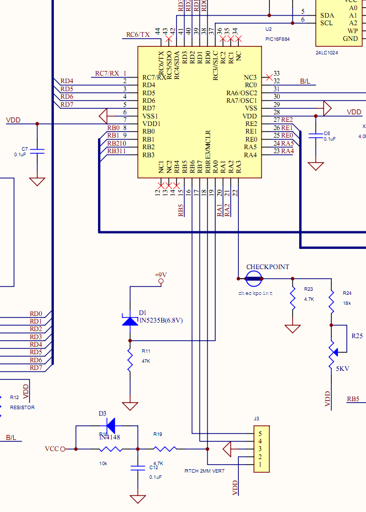

A friend of mine is working on a project and is trying to get ICSP connectivity with his boards with no success. I tried myself and simply cannot understand what could be wrong in such a simple board (it's a mounted PCB, not a prototype). Here are the steps i tried:

I'm feeling really dumb, but i have no idea what can be the problem. The leads seem to be short (they go through a via), nothing seems to connected to the data/clock pins... Anyone have any direction? See attached schematic clipping.

What is the purpose of the resistor and capacitor on Mclr? The normal thing to have is a diode and resistor from Vdd to Mclr with the anode to Vdd - your diagram has it the opposite way around.
I pointed that out as a possible issue, but couldn't understand why it should prevent ICSP connectivity. As I understand the diode is there to protect the rest of the circuitry from the 12V. I suggested cutting the lead before R19 (or removing R19) just to isolate it completely but wanted to hear from the forum first before I make any hardware changes.

Is the RB3/AN9/PGM/C12IN2- pin pulled low? (Speciffically the PGM usage of this pin...)
By default low voltage programming mode is enabled until you set the appropriate config words and if this line is floating the chip gets put into low voltage programming mode whether you want it or not, so you need to ensure it is pulled low, at least until you disable LVP in the config words first time you program it.
The way the diode in your circuit is orientated it allows the 12V to power Vdd. As I said, it's normally the other way around and without the capacitor. I would remove the 10k, the capacitor and reverse the diode.

Once i hold RB3 to ground, both PicKit2 and MPLAB can access the device with no issues - programming/verifying/debugging. I set the config word so that RB3 is a digital I/O (and not PGM, thus disabling its functionality for LVP) and let it float again. PicKit2 software reads/writes/verifies the device just fine whereas MPLAB can read the device ID, but upon programming gives me:
PK2Error0027: Failed verify (Address = 0x0 - Expected Value 0x2800 - Value Read 0x0)
