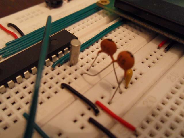

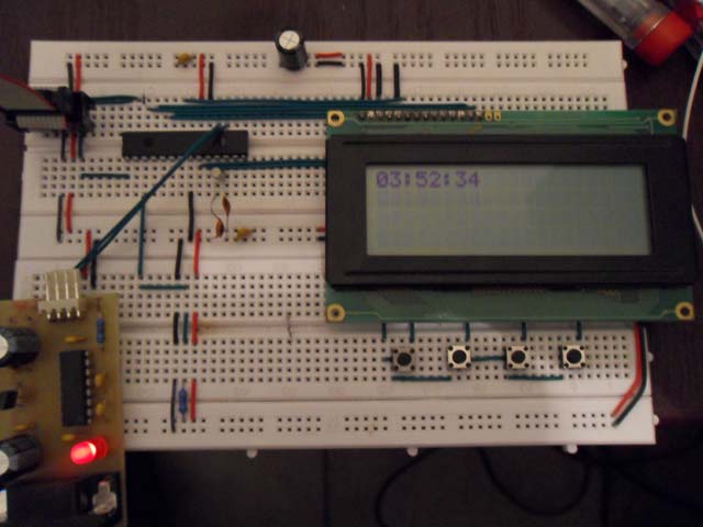

pic16f882 timer1 clock crystal
You can use trimmer caps in serires with static ones too if you have am in value in mind.
So I should avoid a breadboard? Using a 10pf on one leg and 33 pf on another I got accurate time for about an hour...
hi Boo,
Use a epoxy perf pcb with a simple trim cap say 3 to 30pF and the timing accuracy will be within the spec of the crystal and the associated caps.
If you use SRBP perf pcb, varnish the pcb copper area around the crystal and trimmer cap.
Bumping this thread for Pommie mostly.
I am now using a Dallas 32khz clock chip, so I now know it is a software problem. But WTH could be going wrong. I've been trying to get this stupid clock to work foreeeever now!!!!!!
I'll upload my code again maybe somebody can spot something!

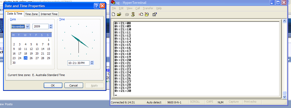

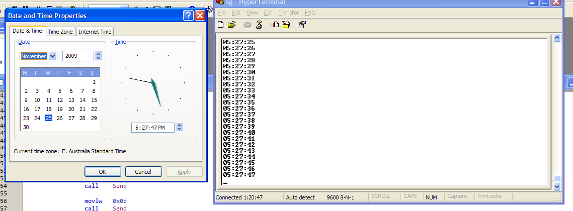

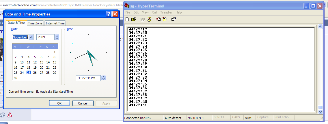

Ignore what I said earlier, I was at school and didn't have access to the data sheet.
I have set you code running on my hardware and I'll see how it is in an hour. See attached, I'll post another in an hour.
Edit, I fixed the set time bit and deleted the seven segment stuff.
Bad news, it kept perfect time and so it's not software.

Edit, just for completeness I'll attach a pic of my crystal setup. As you can see it is quite rough.
Hey Pommie, I fixed the bit, AND STILL NO LUCK! What information could I give you that would help us debug this???
It is off by ~3seconds per hour now...
Only difference is the cap accross mains, but I do not see how that would help...
You should rebuild your circuit. You either have a duff chip or a duff crystal. No way can a crystal be off by 0.1%.
I left the code running. It still shows compliance.

Alright, the problem has been solved!!!!
Let me take you through the steps of what I believe has I had gotten wrong.
1) Probably the most important detail is that I had not synchronized my timer1 with the oscillator T1SYNC bit. When looking at the data sheet I got "confused" or read too fast. I had set it to 1.
2) Equally important detail. After fixing the pic part, how do you know a clock works?? You compare it to another one! I created a program that sends the time from the pic to the computer via serial port and showed it on the screen right next to the PCs time. I was often mislead into believing that my clock was not working because over time it slowly advanced past the PC clock. After researching a bit a came across the program "AtomicClock" which syncs your computer with the atomic clock in Boulder,CO. While using the program I realized that over time my PC would fall behind, but the PIC would stay in sync!!!! I left the clock on overnight to wake up to seeing it was 33 seconds behind the computer and was :(. After running the atomic clock, I saw that my PC was 33 seconds behind!!!!!!
I can't describe how amazing it feels to finally be able to stamp "finished" on this clock :)
Thank you all so much Sam, Eric, Mike, 3v0, and Scead and anybody who I am forgetting :)
