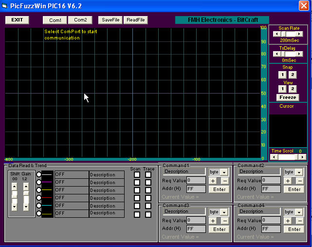

Hi redh_on3/eric
I have a vb6 GUI for the PIC16F..that uses the pc serial port. With the GUI you can continiously monitor variables in the pic (bit, byte, word, FP24) in numeric form or as a trace. You can also write to any variable. The .exe file is about 260k and the vb source about 650k. In the pic i use an interrupt service routine to handle the requests from the pc so it would be fairly easy to include the code (assembler!) into your pic application. The attachement show what the GUI look like. Let me know if you require more info or a copy of the source code.

hi Lourens,
Thats a neat looking interface, 'Red' should try it on his project.
Thanks for the offer of the source, but I already have my own parallel and serial port logger interface.
My regards to sunny RSA.

Wow! looks amazing, Lourens.
It seems too complicated for my project but I'm happy to know more info about yours.
Do you have any simple example code for PIC16F877A connecting to PC (serial port)? whether assembly or C language.
I try to learn from tutorials/project examples but it's too complicated. I'm newbie.
I just need to build a VB interface contains buttons to switch on lamps.

Hi Red
Although the GUI might look complicated at first it is striaght forward to use. The main purpose of the interface is to see what is going on in the pic while it is executing, and then also to be able to modify any variable. This last feature is very handy, it means you can have only an endless loop as the main program and then use the interface to modify any of the registers, including the special function registers; thats how i got my 1st lcd interface figured out and also how i test a new hardware interface. I will prepare you a basic pic application (which will include the serial ISR) for using the interface but you will have to give me time until the weekend. (I also have a version of the GUI for the pic18f)
Wilksey's suggestion of using .net is a good idea which you should consider. If you use 2008.NET on windows 7 there is no need for registering serial port components. I have used .net for a graphical compiler for pic18f's and find it much easier to use.
Regards from sunny RSA.
Hi Red
Here are some source code for those who wants to testdrive the GUI. RedsDemo.zip is the complete pic source. (RedsDemo.asm is the main file if you want to re-assemble - use MPLAB Project/Quickbuild ....) I have used the PIC18F876A (only one i got) for the project. PicWin16.zip contains the VB6 source, including the executable PicWin16.exe. The file Using PicWin16.docx will show you how to drive the GUI and MONITOR01.pwn is the file you can import (use the ReadFile button at the top) to configure the parameters for the RedsDemo PIC application.
For your application i would sugest you write code for the PIC to receive one byte and react accordingly. An 'A' will turn on led, a 'B' will turn it off. Then you can easily test it using an pc application like Terminal. Then make a VB program with buttons to send A and B

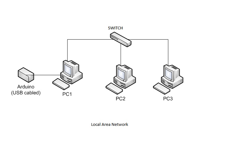

Hi Lourens
Thanks for sharing the program, Lourens. It's awesome.
I've understand how to control the PIC through VB interface by sending A, B and else (Thanks to you!).
But now I changed my mind to use Arduino (Duemilanove). I think it's the same method to control Arduino using VB interface ( I tested it using and it works!).
My work's done if I only have to control it locally but now I required to do it remotely through LAN which means I have to use VB.NET.
I created the VB interface for the local control using Visual Studio 2008 Express Edition.
(attachment: WindowsApplication1.zip)
  • Do you know to make this VB interface available to use for other PC in LAN?
Image LAN topography for my project (attachment: LANtopo.jpg)
sorry for my late reply.
**in case of I'm using Arduino now. Am I have to move to Arduino section?**
  • WindowsApplication1.zip
