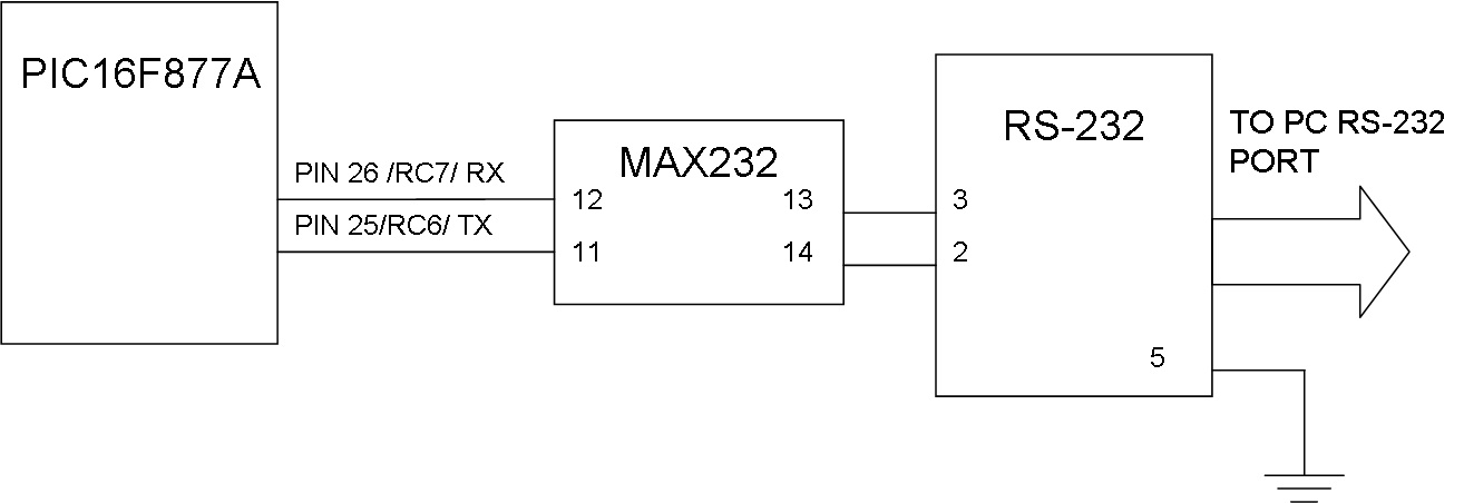

The above circuit looks unnecessarily complicated. Is the transistor even needed? What I did is that I followed this schema:
You have to put in every capacitors in each of their places with the exact values (well, my MAX232PE works with all 1uf electrolytic caps), or else it wont work. I'm guessing that's the reason why your rig didn't work outside Proteus.

Transmit line for the PC is going into pin 1, so is the PIC supposed to be receiving the transmission? Pin 3 transmits out of the PC into the PIC.
This is MCLR, which I know you are using for programming, but piin 39 surely shouldn't be connected to RTS?! Nor would I imagine TX be connected to the MCLR pin.
Your circuit diagram doesn't show any level shift so we cant tell if you have wired it up correctly.

I wasn't aware that you can pull off serial connection using transistors, although I do know there's nothing special about MAX232 except it only does level conversion and inversion. Besides, the OP said that he used MAX so I'm wondering why he's posting a different circuit that forgoes MAX.
For 16F877A, you only need to connect TX, RX and GND to the RS-232. That translates to PIN 24,25 and either one of the GND pins.
or 2,3 and 5 on a 9 way.

I've never, as yet personally, done USART without MAX232...but if the rest of the experts(read:Nigel and Wilksey) vouch for it, then I guess it's doable. So far I've used MAX and it works like a charm.
Speaking of diagrams, here's a simple one showing the connections between the PIC, MAX and RS. Someone look over this too; I might get something wrong.
