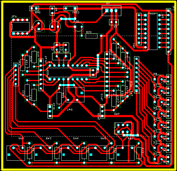

well, i gave it a second thought........
how could i make this board work with both 16F84 and 16F627/8 ?
i need to make some changes in connecting the oscilator.....and how the I/O are connected rigt?
The 16F628 is a drop-in replacement for the 16F84, you can simply pull out the 16F84 and put the 16F628 in it's place. If you want to use the oscillator pins and MCLR as I/O pins, you will obviously have to modify your board - but if you accept the F84 limitations there's no problem.
what about programming the 16F628?
my programmer can program a 16F84 among others, but the 628 is not listed among them.....
i think that it will work....will it?
The programmer isn't any different, but the software is - particularly the configuration fuse options. As long as your software supports the 16F628 you should be OK.
ok.
i am going to design the pcb now.
i will replace the transistors with a 7ch darlinghton driver, ULN2003.
it has the diodes included too....
The PCB!!!!!!
here is the PCB.
on the bottom there are the 5 buttons, on the bottom right there are the leds.
what do you think? think anything should be improoved?

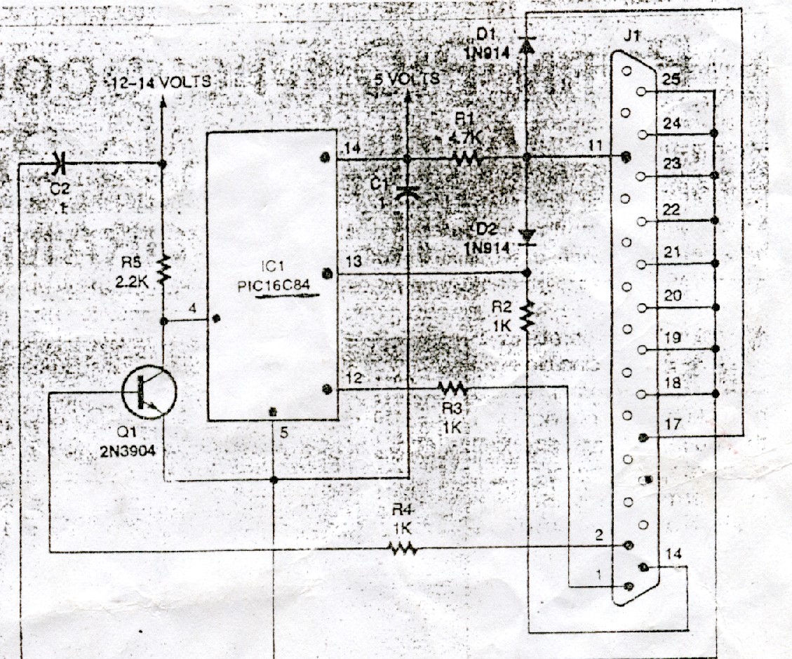

May I ask ?!
Hi Every Body :D
i would like to ask about the PIC Programmer Circuit for PIC16F84 ?? and if i am already have the PIC Programmer Circuit for PIC16C84 , i think i can use it for the first PIC " 16F84 " or not ?? and also for the test one ?? and if anybody know any related circuits or files cous i need them as soon as posiple
[/b][/url][/list][/code]
I'm not entirely sure what you are asking?, but the 16F84 replaced the 16C84 (and has in turn effectively been replaced by the 16F628).
All three chips should be programmable from most PIC programmers, only very old obscure ones wouldn't support them.
Again
i asking if i can replace PIC16C84 by PIC16F84 in the same test or programming circuit , couse i am already have the circuit for the PIC16C84 ???? what do think now ? :shock:
Re: Again
Yes, you can use the 16F84 in the identical circuits.
Hi
Hi every body , now after i can use my circuit with PIC16F84 , so what is the diffrance in the new one " the circuit shown above " and the old one which use PIC16C84 ?? :?:
Re: Hi
None! - the 16F84 replaced the 16C84, basically because of poor code protection on the 16C84 (there was supposed to be a way to turn off the code protection without erasing the chip - by applying a high voltage pulse - the 16F84 cured the problem).
Sorry what do you mean ?? i cant under stand you , and about my main question there are any problem to use th attaceh circuit to use it with PIC16F84 or no " sorry the pics it seems old sorry again !! :cry: "
