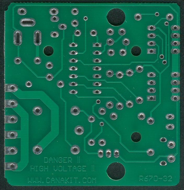

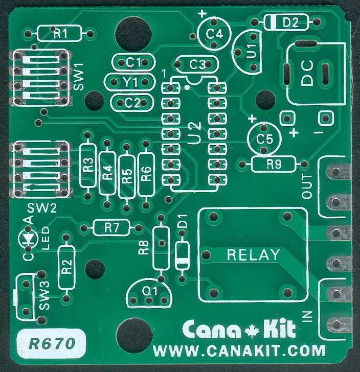

Does anyone need the layout of the PCB? I scanned both sides before building it.

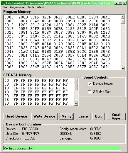

Ian:
Sorry to say it, but the timer does nothing.
Writing to a virgin chip was seccessful. So was verifying (see attached).
There is a fast weak flash from the LED when I apply the power, both in config and run mode, but that's all. Its too fast for the relay to react.
