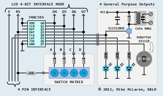

i have been writing and testing some code but the problem is that i have to send 4 bit ( Hi and Low nybble ) and i haven't been able to figure how.. i hope someone can help me out ..

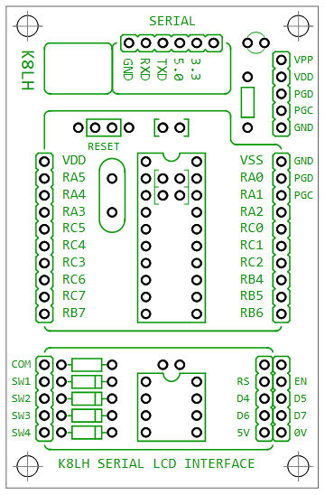

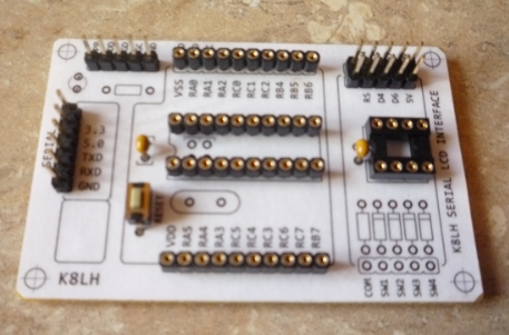

I threw something together last week (below) but my work load at university has kept me from simulating it, let alone finding time to breadboard a circuit, so this may not be much help. My apologies Sir...
Regards, Mike

#define clk_pin GPIO,1          ; to 74HC595 CLK & LAT pins
#define dat_pin GPIO,5          ; to 74HC595 DAT pin
#define ena_pin GPIO,2          ; to LCD 'E' pin

PutCMD
        clrc                    ; C = RS = 0 (command)            |B0
        skpnc                   ; skip                            |B0
PutDAT
        setc                    ; C = RS = 1 (data)               |B0
        movwf   work            ; save data                       |B0
        call    PutNyb          ; send hi nybble                  |B0
        swapf   work,F          ;                                 |B0
        call    PutNyb          ; send lo nybble                  |B0
        DelayCy(40*usecs)       ; 40 us inter-char delay          |B0
        return                  ;                                 |B0
;  shift out RS bit, the hi nibble bits, and one extra clock
PutNyb
        bcf     dat_pin         ; dat = 0                         |B0
        skpnc                   ; RS = 1? no, skip, else          |B0
        bsf     dat_pin         ; dat = 1                         |B0
        bsf     clk_pin         ; clk = 1 (strobe clk)            |B0
        bcf     clk_pin         ; clk = 0                         |B0
b7      bcf     dat_pin         ; dat = 0                         |B0
        btfsc   work,7          ; b7 = 1? no, skip, else          |B0
        bsf     clk_pin         ; clk = 1                         |B0
b6      bcf     dat_pin         ; dat = 0                         |B0
        btfsc   work,6          ; b6 = 1? no, skip, else          |B0
b5      bcf     dat_pin         ; dat = 0                         |B0
        btfsc   work,5          ; b5 = 1? no, skip, else          |B0
b4      bcf     dat_pin         ; dat = 0                         |B0
        btfsc   work,4          ; b4 = 1? no, skip, else          |B0
        bsf     clk_pin         ; clk = 1  (extra clock)          |B0
        bsf     ena_pin         ; ena = 1  (strobe data)          |B0
        bcf     ena_pin         ; ena = 0                         |B0
        return                  ;                                 |B0

Just wanted to mention that there are alternatives for the 3-pin interface you're building which may have advantages in one way or another...
Cheerful regards, Mike

I finally started building a prototype board yesterday for the 8 pin, 14 pin, and 20 pin "enhanced" mid-range PICs (which all share a common pin/port architecture). I'm using a cheapie phenolic 1.8" x 2.8" Radio Shack prototype board with a homemade paper silkscreen. When I finish wiring it up I'll throw a 12F683 in it and breadboard a 74HC595 and LCD in order to test that LCD software (probably next week during the Holiday).

looks like a nice setup Mike :) i'm also about to design a circuit for the 683 but i'm using gEDA and mail the gerber files to iteadstudio .. it takes a few weeks to get the boards but it is sure worth waiting for :) the cheapest boards are 2X2 inches ( 9.90 +4 dollar PP) .. i usually get 12 pcb's.
I also notice that you have a ICSP header . how do you isolate it from rest of the circuit ?
another question i have .. Is it possble to have more than one button connected to a singel input on the 683 ? i was thing about adding 4 buttons and maybe usinge a voltage divider for each of em and do the rest in software.. can it be done that way ?
