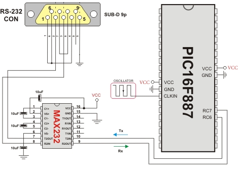

can somebody give me a basic circuit diagram in building a GSM circuit to be interfaced with PIC16F877a? i really don't want to buy a pre-designed module so please help me out.
before you start, you need to know some points:
1) You need to know how to do serial connection using UART and how to configure it
2) You need a GSM modem (most of them support serial communication).
3) You need AT command datasheet to allow you play around till you get the best design you need
it is just a matter of interfacing, connecting 3wires from modem to pic16f877a through max232 converter,
supplying power to both mcu and modem, do your coding and so on.........

They are provided in the datasheet of the GSM module (or GSM chip) that you use.
'Generally' they are standard AT commands (as for any modem - google them), but with a few specific extras and differences.
