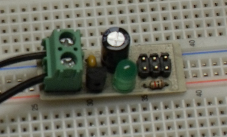

I buy power adapters at the local thrift store. Mostly I use ones with 9VDC output. I cut the end from the DC cord and solder a little card with a 5V regulator on it. Works like a charm.

3V0, why do you add a 5 volt regulator to a 9 volt supply? Why not use a 5v supply? The ones for cell phones work well. Just be sure that they are regulated. The small "non-cube" switchers are almost always regulated.
The cell phone here because are recycled, handed out to battered females. A good thing. I buy mystery wall warts for $1 or less at THE local thrift store. They often go to students so I need a slow but steady supply.
Using know regulation may be "belt and suspenders/braces" at times but it also gives me over voltage and short protection. It also allows me to use a wider selection of wall warts.
I made a bunch of the regulator blanks a while back and it only takes a few minutes and about $1 worth of parts to populate one with the voltage regulator I need. Note that at most I use 300mV TO-92 case regulators with this PCB.
To a degree this is a to each his own sort of thing. Some people like to build regulator boards with multiple voltages or even adjustable ones. I use these in my teaching and less options means less problems.
