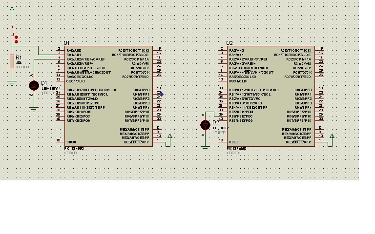

Hi all,
I am new to this forum. Please help me. I am designing PIC-PIC connection using rf link. I am using PIC18F4550. Could u all please comment on the circuit I have attached. I don't know whether the circuit is correct or need some addition. Thank you
Pin 25-->Tx
Pin 26-->Rx
Pin 13&14-->20MHz
Pin 11, 32-->Vcc
Pin 12, 31-->GND
Unless you are planning on using an RF module for communication that has some intelligence built into it, you will need a way to syncronise and recover your clock at both ends of the link. This is usually achieved by using a signal encoding method of some type, most commonly Manchester.
Without being able to sync and recover your clock, there will be no reliable way to send/ receive data.
I see from your schematic that you have two Micro's, LED's and a switch, but where are your transmitter/ receiver modules etc?
You will not be able to use the standard built in UART for your RF link, you will need to write the code for both transmit and receive and bit bang a couple of port pins. I have a vague memory that Nigel Goodwin has an example and tutorial of how to do this on his site, but I could be wrong. His tutorials are worth a look through in any case
rgds

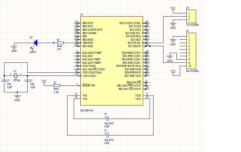

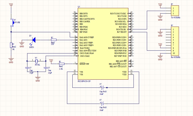

I am sorry for the inconvenience before. Hereby, I attach the circuit for my transmitter and receiver. Could u all please help me take a look at it and give any comments. Thank you.

Using the USART either software or hardware is possible but I found it to be problematic. What sort of data do you want to send? There may be better ways to do what you want....best to give more details.....purpose of application, compiler you are using etc.
Your circuit is not the biggest issue....it will be the code.
