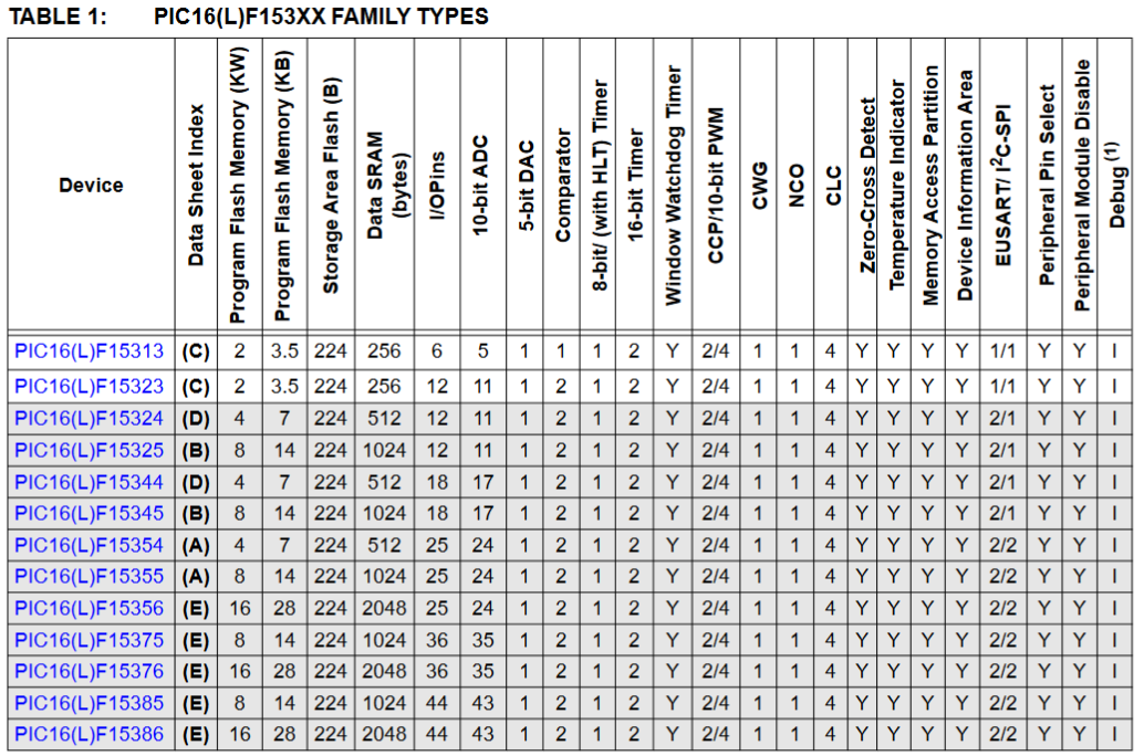

"...do they have any specific advantages?"
They are pretty loaded...
My two current favourites are these two, lot's of memory and lot's of peripherals, and (most importantly) they both include the SMT timer module, which I use a lot. The new enhanced 16/18 devices are pretty impressive.
