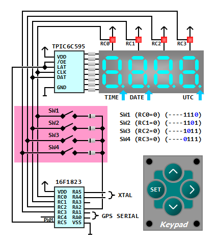

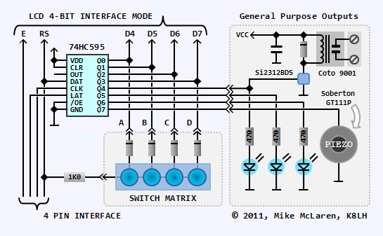

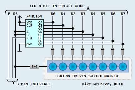

That's some really great code Mike nice work thanks for the post.
The switch management technique I'm using on my latest project involves scanning them. Even though there are only 4 switches total and it uses up one more pin on the PIC than it would if you simply had them on 4 input lines. The beauty of this setup is that I only need one pull up resistor on the "common" pin, then use four output lines that I set low, then high sequentially as the common pin is polled each time the lines are set low.
Hi Jon,
That's a good hardware technique and it costs you even less pins if you can mux' the switches with the column driver lines on a 7-segment LED display or with the data lines on an LCD display;
Regards, Mike
