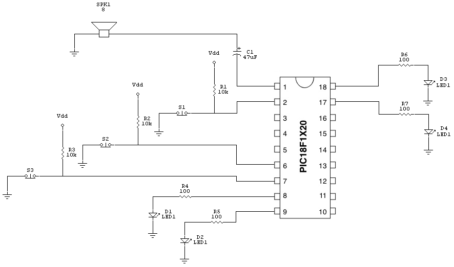

Project:
I just began programming with PICs and have run through a series of projects to exercise my skill level in programming; this particular project is entitled a "PIC Sound Generator" in which it will generate notes at my command.
Theory & Operation:
I begin with all my header files, definings, etc. until I reach my first function. This function allows me to enter a note that I previously stored into an array, and then define how long of a duration I wish it to play for.
My frequency is set by Timer0 on the PIC, in which I rapidly turn RA0 on and off depending on my TMR0L and TMR0H values, and furthermore, my array value. TMR0H and TMR0L enable me to use 16-bit mode since my lowest note is 1515μS. Remember that I wish to know my lowest frequency note since the delay is longer. If I were to use 8-bit, my maximum delay would be 128μS. Thus, equation for 16-Bit timer:
[LATEX]Frequency Delay = ((65536 - Delay)*0.5uS)*2[/LATEX]
Which simplifies to:
[LATEX]Frequency Delay (uS) = (65536 - Delay)[/LATEX]
It has already been noted to me that Timer2 would be a better choice, but I wish to become more familliar with all the PICs abilities and attributes, so I will eventually learn about Timer2 as well.
In the main() function, you see I have a long list of the playNote function commands. These, as I mentioned, give me what note I want and for how long I wish to play it. The latter statement is based on whole notes (actually quarter notes) and half notes (actually eighth notes). The music for the third song is depicted here, as an example:
The time signature is 3/4; meaning there are 3 quarter (1/4) notes per measure; or section in my comments. Therefore, to make the music even, a section must eventually add up to 3 quarter notes. Otherwise, the music becomes convoluted and not very pleasant to listen to. I can, at my disposal, change how fast I want my music to play if I change my WHOLE or HALF values previously defined at the beginning. Note that they correlate with one another; if I have 800 as the WHOLE, I must have half of that for the HALF value. I was fortunate to have experience in this regard (I play classical guitar), so that made things much easier.
* Using PIC18F1320, with C18 compiler

Video in action:
uC Project :: CreatingSound3.C video by ElectroNerdy - Photobucket
I'd like to thank 3v0 and Hayato for their support!
Thanks,
Austin
